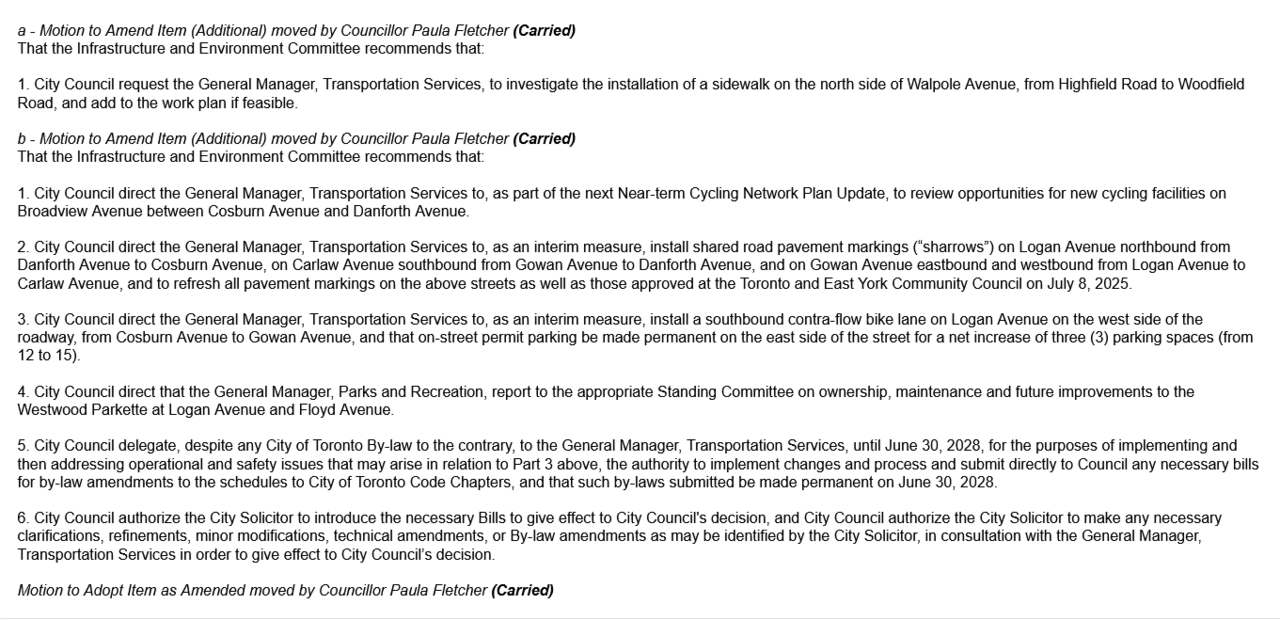

The Cycling Report just passed Ctte, with the following Amendments:
Then

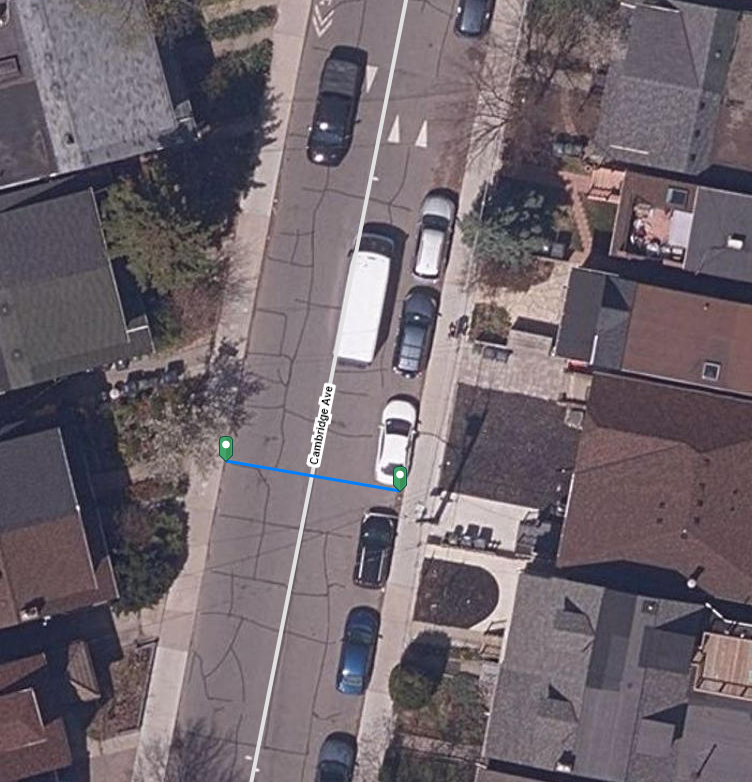

Here's what you have to work with:
That's 9.5m curb to curb, deduct 2.5M for the parking, you have 7M left.
A very minimal, sub-standard bike lanes is 1.5M (Toronto would generally require 1.8M)
Re: One-way. Nope.
If you look at the, very south limit of the street is one-way SB to Danforth, and for a variety of reasons, flipping to NB is not on.
IF you went all SB, you run into a variety of challenges, no left turn to Danforth makes it very problematic, further north you also have a major apartment building with parking.
Possible.
Through Broadview north of Cosburn has cycling facilities, and it isn't all that high traffic at most times.
Adding facilities right at the Danforth approach (with streetcar tracks present) would be a real challenge though.
Edit to add:
There is no way to add cycling facilities at Danforth, beyond a sharrow, with the buildings on the west side coming down. There just isn't the room.
So I don't think a Broadview extension is super likely. Looking at where it may serve some utility, there would be an argument for taking it to Pottery/Mortimer. After that, it might feasible to consider contra-flow lanes on Browning/Fulton to make the E-W connection to Logan.
Cycling facilities on Cambridge to (beyond Sharrows) don't appear feasible to me unless you remove parking.

If I understand it correctly from this motion, Fletcher added Logan contra-flow bike lane back to the report and only Carlaw remains one way with sharrow ?
Only one block of Logan from Cosburn to Gowan would get a contraflow bike lane. This is to make Carlaw accessible from Cosburn.
