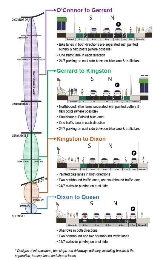

Ugh, city staff still putting lanes on the wrong side of parked cars, using subpar safety infrastructure where it's in the right place, and refusing to budge on the minimum possible width for protective materials where they do place it.
City councillors and a few mayors are most to blame for the dire straits of Toronto's current cycle infrastructure, but more and more I think the Transportation department is also complicit in the current state of affairs.

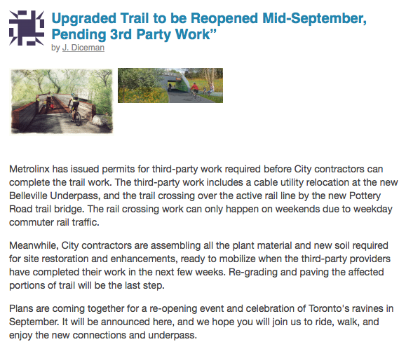

Don Trail Update

You do realize that the Woodbine cycle tracks between O'Connor & Gerrard (2/3 of this project) will basically be the widest cycle tracks in the City at 2m CycleTrack plus 1-1.2m buffer with protective posts.
Minimum for bike lane is 1.5m, Woodbine is getting mainly 2.0m; but also 1.7m, 1.6m & 1.8m. Minimum for buffer of protected bike lane is 0.3m non-posted paint only buffer, Woodbine is mainly getting 1.0m & 1.2m posted buffer; also 0.6m posted buffer.
What's stupid is that cyclist along Woodbine would have less and less protective cycling infrastructure (narrower bike lanes and shared sharrows) as they get further south closer to heavier cycling areas like Queens Street, the Beaches and Martin Goodman Trail.
Given the current form, I don't think there's a right side. Any bike lane adjacent to parked cars is the wrong side and any solution that doesn't eliminate street parking next to bike lanes is only pretending.
I'm totally with you conceptually, but I'm also trying to operate in the realm of the possible given this mayor, this Council, and this Transportation department.
I know a lot of advocates for safer cycling would disagree with this, but my personal view is that moving all of the most important parking-adjacent bike lanes in the city from the driver door side to the passenger door side would greatly improve the quality of the overall network. I lived in NYC for years, and really appreciated the bike lanes where they did exactly that.
Im not really sold on having bike lanes on the passenger side of parked cars tbh, so Im glad to see this. I've had far more close calls on Bloor where the lanes are on the passenger side than on streets where it runs along the drivers side. It's nice having the buffer from moving traffic, but I've had far more close calls from dooring than from cars running along side me.
I find drivers more attentive to cyclists when opening doors. (especially since they risk losing a door to a passing vehicle if they aren't careful when opening it) Passengers suck.
I find drivers more attentive to cyclists when opening doors. Passengers suck.
Yeah, I totally understand the notion and have heard lots of folks share that opinion, and I don't rule it out of hand. There are lots of studies that have shown that, statistically, there are fewer cyclist injuries and deaths with parking-protected bike lanes versus the opposite (recognizing that all that data is location- and circumstance-dependent).
