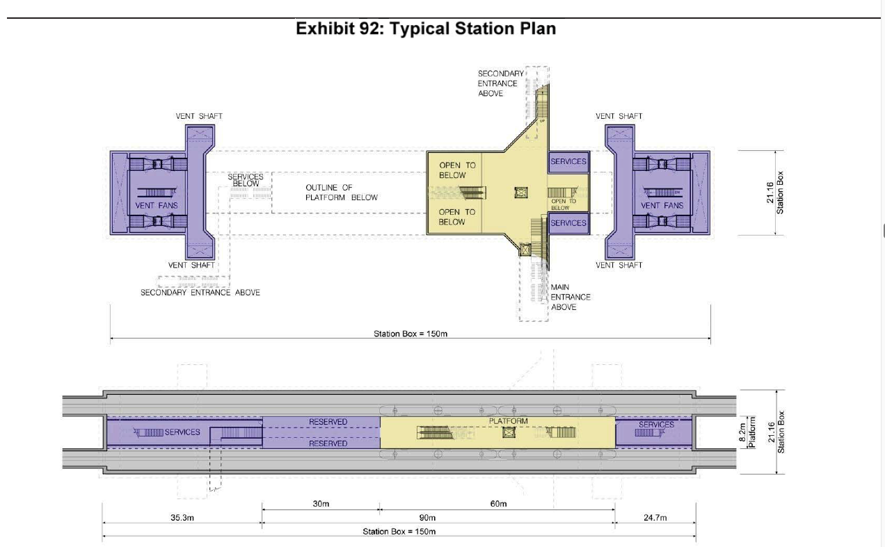

From link.
That makes them almost the same station box length of Toronto's legacy subway platforms. While 90m is about 3 Flexity Freedom light rail vehicles in length, that could be extended to 5 Flexity Freeom light rail vehicles, if they make use of the entire station box.
They won’t never be able to make use of the entire station box. Electrical rooms, ventilation equipment and storage will always occupy some part of the station.
Those electrical rooms and equipment would be on the mezzanine level (above the station platforms and below the entrances).
