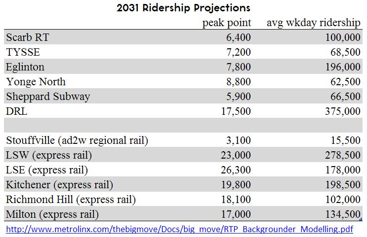

On the issue of ridership / modes / priorities / promises, I stumbled on this 2008 Metrolinx RTP Backgrounder Modelling and on p27 it gives some interesting numbers compiled together. Might be useful for this debate, but also for region-wide transit in general.
Scarb RT: 6,400
TYSSE: 7,200
Eglinton: 7,800
Yonge North: 8,800
DRL: 17,500
And I also have trouble understanding why Tory and the Prov are so keen on Stouffville GO when its projected ridership is so low compared with other corridors.
Stouffville: 3,100
LSW: 23,000
LSE: 26,300
Kitchener: 19,800
Richmond Hill: 18,100
Milton: 17,000
Seems with transit projects (and their ensuing debates) the most important numbers to gauge a line's worth is average weekday ridership. This kinda makes sense, since with a line like Sheppard we all tend to quote how its ridership is on par with surface lines such as 504 King. In the 2008 Metrolinx Backgrounder it does provide us with annual ridership projections. I'm not certain, but I was under the impression that in order to get daily numbers from annual you simply count a weekend as one day (i.e - to get daily from annual you divide by 312 days). So if anyone wants to see how certain lines/extensions weigh up against one another in this manner, this could be handy. All I did was the annual->wkday math, so I can't speak to the validity of the numbers beyond simply pointing to their source.

I'm not sure the sudden interest with the 2008 modelling numbers that we've discussed widely and extensively on several occasions since they were released in 2008.
Where's the 312 coming from? Typically 300 is the rule of thumb ... though on a very weekday dominated system it's a bit lower, and on places with very high weekend traffic (i.e. TTC) it's bit higher.
I just thought it was interesting to have all the numbers compiled in one source. Many times when trying to find numbers for projects involves dead links, or individual reports for individual lines. The talk of Transit City and early Big Move made it seem relevant to the discussion of Scarb.
And I asked on the site how to get daily from annual at one point, no one responded. And I remember reading on Steve Munro once that a wknd counts as one day. So 52 weeks x 6 days = 312.
Oh, I missed that. 300 is the old rule of thumb, and close enough. 312 might work better with TTC - less so on many systems though. Not much difference really in the greater scheme of things!
Interesting that Eglinton's avg weekday ridership is so high in comparison. Really shows how well used the Crosstown is going to be offpeak, which is believable considering day-time bus ridership on Eglinton.
