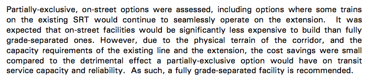

From the EA:
You want a gauge of riderhsip east of STC? Just look at the Progress bus.
The Progress bus alone is not entirely indicative of the line's ridership. You do realize that the Progress bus is one of several routes between STC and northeast Scarborough? And that there was a 7-bay bus terminal planned at the terminus of the RT extension? In transit network analysis, this concept called "feeder routes", which (among other factors) means that the line's ridership does not necessarily = the bus it replaces.
