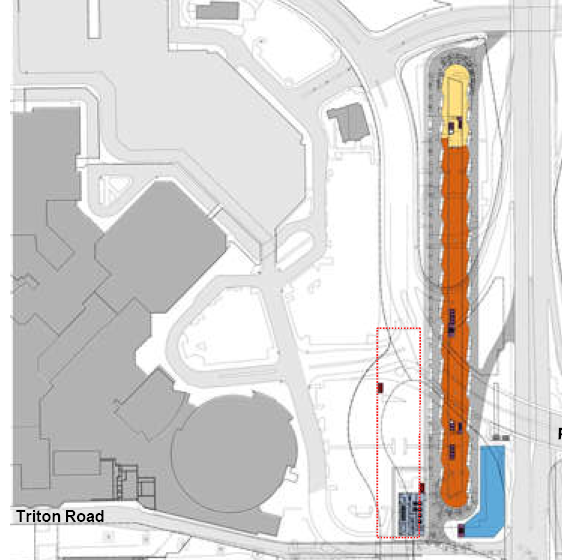

This reaction over the proposed bus terminal walking times at Scarborough Centre just sounds to me like more veiled pleas not to build the subway extension. We can do better than this. Plus we all know the major, busiest routes will have bus bays proximal to the subway station box, it's only infrequent, lesser used routes like 132 Milner where the walking times may be more extensive.
You can reject a bus terminal on its' own merit letting constant the BD extension. The proponent can do better than this.
Nobody is going to cancel a $3.5 Billion subway extension because of a $0.2 Bilion flawed bus terminal. That's would be ridiculous. You can completely build the extension while modifying the bus terminal to be pedestrian friendly. We're not doing ourselves any favours by pretending flawed elements of the project are perfect. That's how you end up with situations like the current SRT to Line 2 transfer
All I'm saying is that people have had to tolerate the lengthy walking transfers at Finch Stn for decades and we don't hear many people complaining about it. For instance, the distance from say the 99 Bayview bus bay in the YRT/GO terminus to the 36 Finch West bus bay right at Finch Avenue is quite a walk. Finch also involves navigating lengthy corridors and many flights of stairs/escalators to connect with the subway platform.
Claiming that people won't complain isnt a particularly compelling argument when we have obtuse transfers on the TTC, such as the Spadina Line 1 to Line 2 transfer, that people frequently complain about.
Also the Finch transfer is much, much shorter than what's proposed for Scarborough.
And whether or not they complain about it, it's a factor that's slowing their trip and making transit less attractive. Ideally we're not building transit to pacify complaints, but rather to move people as effectively as possible.

Okay, fair enough. I see where you are getting at.
Ideally the SCC station box would be built as directly to the pre-exisitng bus terminal as possible to avoid issues of long walking times, but if it must be shifted east, I suppose a better solution would be a stacked bus terminal like Wilson's directly atop the subway with up to three sets of elevators directly linking the upper and lower bus platforms to the subway platform.
The images I recalled of a bus terminal on top of, or at least alongside, the subway platform were from the Value Engineering study done last fall: http://www.scarboroughsubwayextensi...ay-ext-final-ve-report-combined-v5-nov-23.pdf
Around p.149 you can see some primitive sketches of the new layout, but they suggested recycling the existing bus terminal. Now it seems, in keeping with the spirit of this project, Demolish Everything.
They didn't go with this configuration because they want to maximize developable space. The proposal in your image would require building the terminal on parking lots adjacent to the mall that could be developed.
That's an unacceptable tradeoff, in my opinion. In all likelihood, the development at this location will be high density residential, which we all know is a very poor source of transit ridership compared to commercial developments. On this land we'd get maybe 1,500 residential units (that's roughly 3,000 residents), and only a fraction of those residents would even use transit. This pales in comparison to the tens of thousands of daily commuters that will be negatively impacted due to poor terminal placement.

Is there anything preventing a design to split the bus bay into two. Half on the east side of Progress and half on the west side to straddle the subway station. It looks like access on the west side could easily be done on either Progess or Triton.
