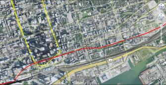

Here's the best DRL alignment through the east side, IMO.
Going up to Wellington allows for a station just north of Union, making an easy connection between King and Union station as one station. Further west, there'd be a station at Simcoe St. with an easy connection with St. Andrew station. In the East, there would be a station right on Front St before Jarvis, to get right under the St. Lawrence market. Then's a station set between Trinity and Cherry, to serve the Distillery District and the Cherry streetcar/LRT. After that, it'd connect back with the Rail Corridor.
I'm sure I somehow messed up in embedding that image... I'm learning.
EDIT: If I could be enlightened as to how I might fix my image, it'd be greatly appreciated :)
I second this! Pretty much identical to the alignment I used in Move Toronto.
