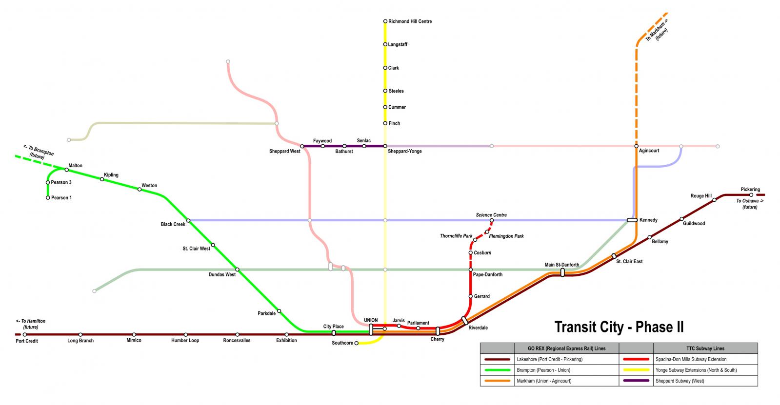

Transit City - Phase II: A Mix of Regional Rail and Subway extensions (like has been discussed here).
4 Subway Projects (DRL, Sheppard West, North Yonge, South Yonge)
3 REX Projects (Lakeshore, Markham, Brampton). The REX Projects only extend to their 'local route' terminus points in my earlier GO REX map (in the fantasy thread). Reduces cost and provides service on the most needed parts of the lines.
I chose Lakeshore, Markham, and Brampton because those 3 lines are the most useful to transit in Toronto. Metrolinx has already prioritized the Georgetown and Lakeshore corridors for electrification, so I just added the Markham (Stouffville) line to the mix. That line will be a God-sent to Scarborough residents wanting to get downtown.
