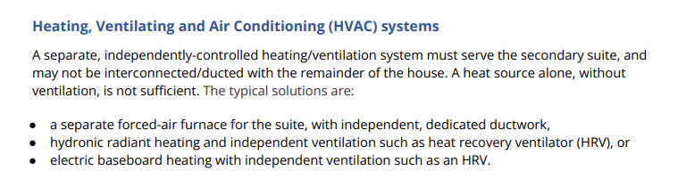

I had it brought up to me today that the Alberta Building Code requires secondary suites to have a separate heating system. Does anyone know if furnaces that have zone control (separate thermostats, shared furnace) qualify as "separate" systems?
I don’t believe so
You can use something like an HRV or ERV that has heating, but might not be cheaper than a separate furnace.
Thanks Greenspace. It's less of a cost issue and more of a "this seems like a Building Code oversight" issue. Multi-zone HVAC being acceptable for apartments and other multi-family structures but not for secondary suites is strange to me.
I believe some of the secondary suites (Basement) at Blatchford were on the same HP as the rest of the residence. At least the ones I reviewed did. The Garage suites were only on the geo water lines.
Are you sure they were legal secondary suites? Or maybe the heating permit was inclusive of multiple furnace units? I'm not overly familiar with these permits but per the City:
I am very curious how the Blatchford units have one permit for two suites, it's not like the City could exempt them from the Building Code.
