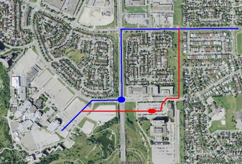

I know it's late but I would like to propose an amendment to the route of the FW lrt. My concern is the route around William Osler Hospital (Etobicoke General). Currently the route is to run the line from finch to hwy 27 south then west at Humber College Blvd., this places the nearest station to the hospital at the intersection of Humber College and 27. I would prefer to see the line turn south at the Hydro lines (east of 27) and west at Humber College Blvd, then dog leg south onto the hospital property and then west to Humber College.
I've tried to attach a simple map showing what I'm thinking, with any luck it should be here:
I reason that it would be better to get the station closer to the hospital and heath buildings considering that it may be older, less fit, ill or people of reduced mobility going there and that having a station at 27 might be to much for them. As well if the route crosses 27 about 50m south of Humber College Blvd then a bridge could be built over 27 so that the lrt does not interfere with the already busy 27/Humber College intersection. For those who may not be familiar with the area, the 27 road drops into the Humber Valley south of Humber College there so the roadbed is already about 3m lower than the surrounding ground so a bridge wouldn't be to difficult with regards to grades and road clearances.
My friends, what do you think?
I also think it helps to not have LRT turning at the already busy Highway 27/Albion intersection.
I also think it helps to not have LRT turning at the already busy Highway 27 intersection.
I would rather have the LRT follow the hydro line down from Finch to Humber College Blvd and William Osler Hospital, and then have a bridge over highway 27, since it is in a cut at that point already. The problem I only see is the loss of a park and playground in the hydro right-of-way.
Good idea. I wonder, however, if it would be possible to better serve the hospital at the same time as providing service to the employment lands north of Finch? What about running WB through Hwy 27 to HCB, then south/southeast/east along HCB and through Hwy 27, and finally north through the hydro corridor back to Finch?
Edit: Having thought about it, I am not in favour of any changes that would require a new EA or would otherwise delay construction.
I agree that he line should serve employment areas as well as residential areas but I don't like the loop. I imagine that sometime in the future the FWLRT and EglintonLRT will meet up at the airport (via Rexdale/Derry road and s along Airport road serving my town...oh please) and a loop would prevent that.
