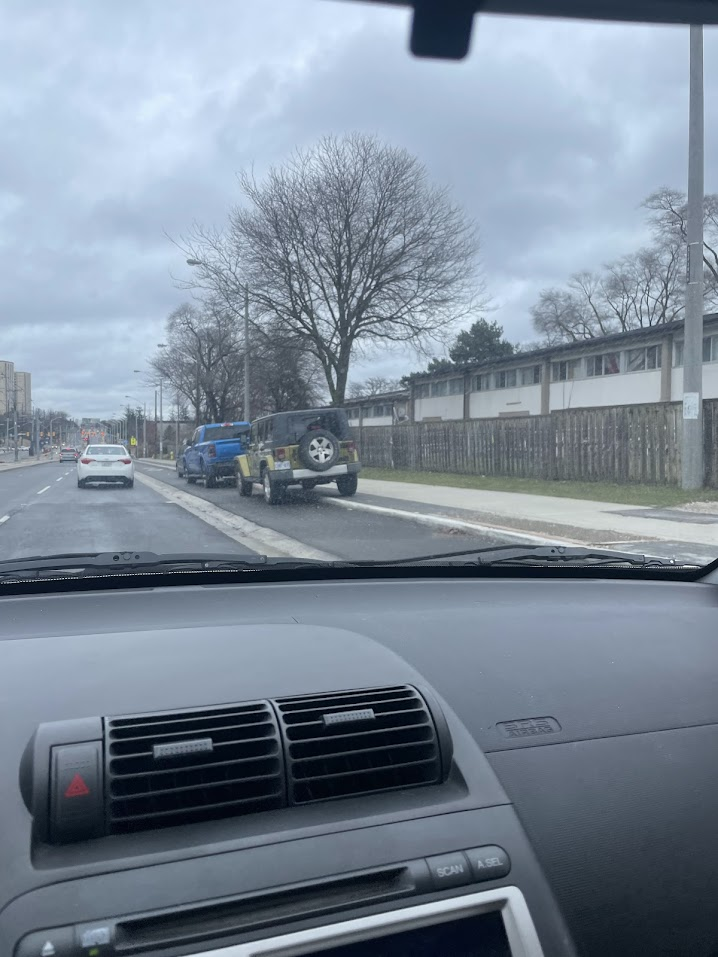

In a similar experience to @yoshirocks702 I encountered numerous people parked on the cycle tracks while travelling along Finch from the 427 to Jane.
The rolled curbs of the cycle tracks along the entirety of the LRT routing is honestly malpractice in 'safe street' design and I cannot figure out why they've done it like this. Vehicles parking or even carelessly swerving into the cycle tracks can do so without concern for even a scratch on their vehicle.

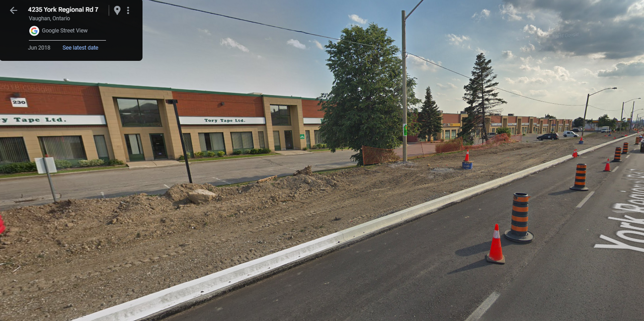

Apologies for the less than ideal photo, but even in the suburban realm of Vaughan on Highway 7, they figured out the rocket science required to build a cycle track with a hard curb.

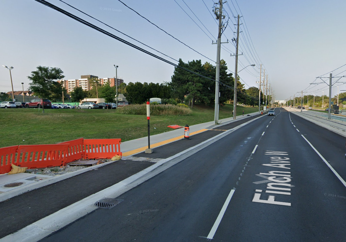

I emailed Transportation Services thanks to @Northern Light and heard back really quickly, basically they said the rolled curb design is for emergency vehicles to pass through as finch isn't as wide as Hwy 7 which makes sense.
I suggested they add some flexible bollards and more signage similar to Richmond and Adelaide to help, but this project is still with Metrolinx so until they hand it back to the city not much can be done at this point which also makes sense. There is clear "no stopping" signs posted now but that doesn't seem to be effective at all.
Honestly I don't buy it. The width of the cycle tracks is nowhere near what's needed for active vehicular travel and the cycle tracks rise at intersections so any particularly wide vehicle (say an ambulance) would have half its wheels hanging off the edge of the curb. We have precedent for actual emergency vehicular bypass bike lanes on University, and these are clearly not that.
Never mind the fact there actually is a newly built reserved vehicular right of way built with cut curbs at points to allow emergency access, the FINCH LRT lol.

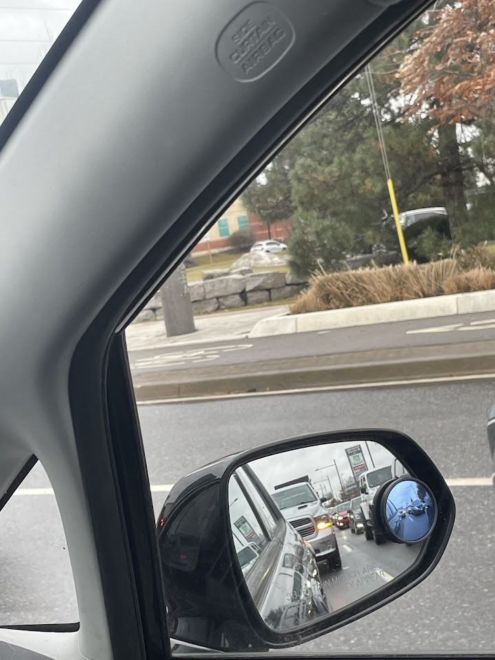

I happen to noticed that there is a car sitting not only in the bike lane, but also on the sidewalk in my last photo I posted on Tuesday. Never noticed it until I looked at it last night in a posting.
It maybe possible once service starts and cycles start using the lanes, cars will stop parking there, but wishful hopes since those drivers don't care what they are doing is illega in the first place.

Definitely sympathetic to the internal processes that make this difficult, but the curb protected cycle tracks in Vaughan I posted were constructed in 2018-ish. We can assume the design was then put together at earliest in 2016, and likely earlier. The fact the cycle tracks we see today on Finch were ever the planned design is a condemnation of Cycling/Pedestrian unit.
