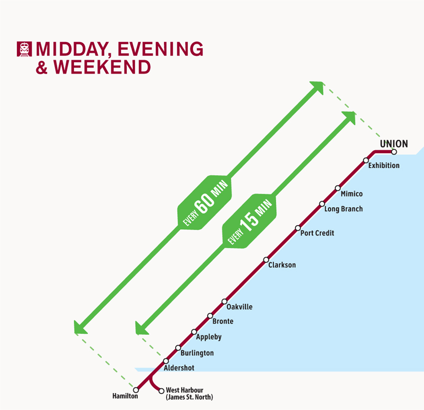

Although CP is an issue, West Harbour also requires GO trains to "cross over" CN's freight tracks (as GO's tracks are on the "lake side" of the corridor at Aldershot and on the opposite side at West Harbour), which causes conflicts and limitations on capacity. It's kind of a similar issue as in Brampton.
Aldershot gets electrified 15-min all day two way service, while Hamilton downtown gets hourly diesel all day service.
In the earlier RER announcement, electrification is announced only to Burlington, but in this diagram, it appears they've de-facto clarified this and is electrifying to Aldershot.

Let's say hypothetically, Phase 2 of GO RER includes a 15-min electrification extension to Hamilton. The elephant in the room for Hamilton Downtown (Hunter) is the single-track tunnel. That's going to require a second expensive megaproject, in addition to a rail-to-rail grade separation.
Based on this, it would be easier to electrify to West Harbor GO (JamesNorth) than to Hamilton GO downtown (Hunter).
