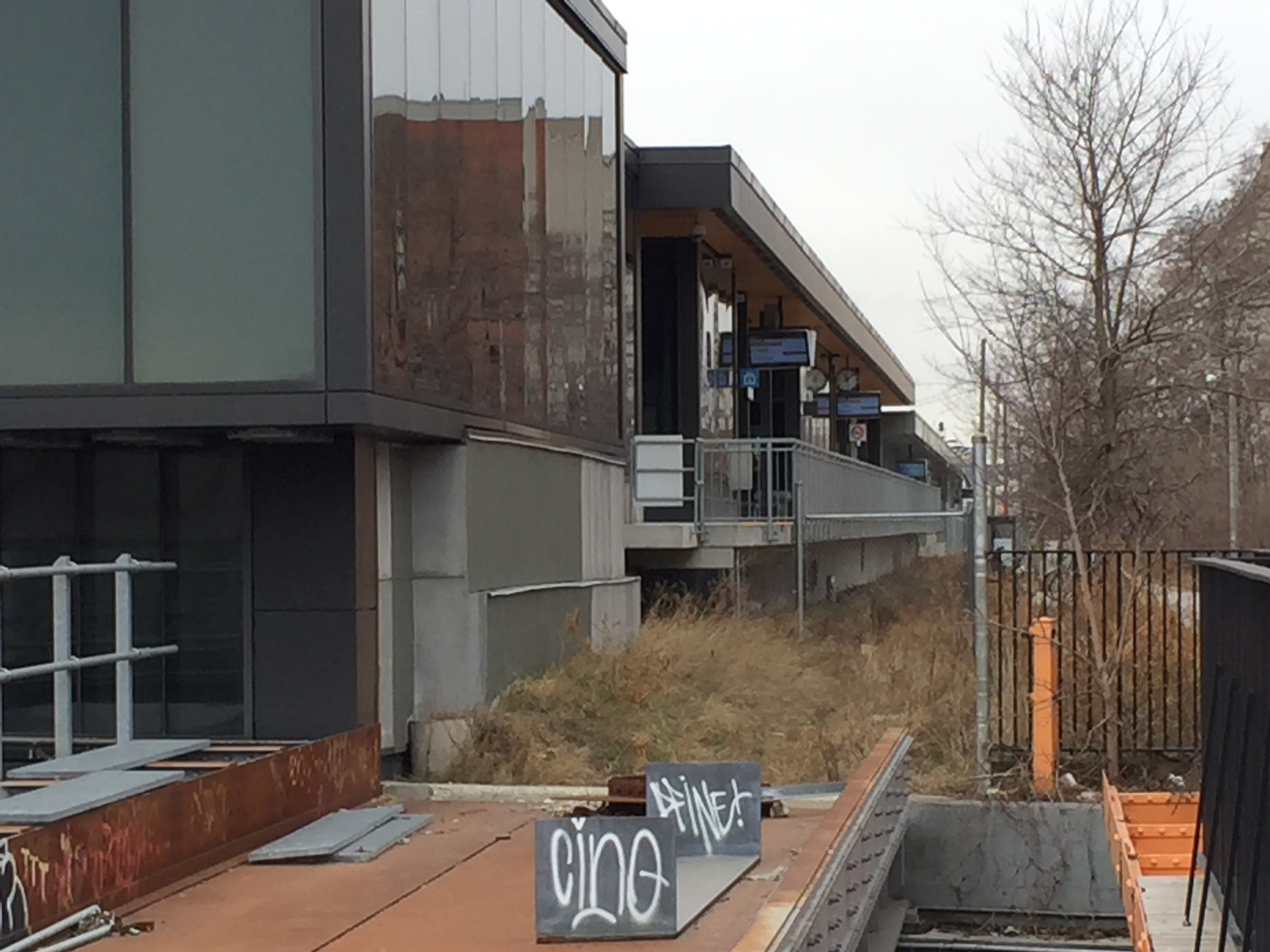

I'm certainly not an expert but wow, that does look close.
After taking a quick peek, it has me shaking my head. The bridgework ends so close to the corner of the station that there is little room to bend the rail. And the overhang on the platform is not that wide, so the track has to clear the concrete footing. Perhaps the north end of the bridge can be modified. Shifting the bridge itself would be basically starting over, and would require a shift of the railpath bridge also.
If the clearance is there, it's only by a few cm's.
Back when the project was building, I heard some grumbling about clearance issues, but more in the context of contractors taking liberties with the drawings which forced rework. Don't know if this issue was connected.

This is the best photo I've seen, illustrating the clearance problem with the bridge versus the platform edge.
While we don't know the full story behind this, I sure hope this isn't too expensive to fix. This track will be needed eventually someday, even if not right now -- given the number of services GO/VIA/City/province/etc wants to cram down the Georgetown Corridor.

Passing that spot four times today, both under and over the trail bridge, I can now be reassured that where the new bridge is right now is impossible for use. Present position has to be be a staging point for sliding it over. It's now positioned as far west as it can be on the sill in the buttresses. I've sighted angles from up on the trail bridge to what appear to be the bolt fastenings on the street median footing below. The real question is whether the trail bridge can retain the vestiges of the west side catwalk. (It's the oldest of all the bridges there, albeit I do see some solidified resin drip from the most recent concrete pour on it, probably to seal the steel superstructure) .
I have a theory as to why the support piles are down into the concrete street median: It's to ensure greater reluctance to the vertical supports being bent out of alignment when the span is jacked the few feet needed east. Whether those same vertical supports can be re-used when cut off at the base and attached with angle brackets to the new base plate is a good question. The plan might be to leave them in place as the span is jacked onto a new one already pre-positioned.
At present the span is secured by nut and bolt, minimally so. It appears my alarm over a screw-up was pre-mature, but how the span is moved will entertain many viewers!

Again, many thanks for those pics Paul, they clearly show the cause of my initial concern.

I have to disagree. That bridge is a brand new build, nothing like any of the others. Not only is it new, it's built in a different way with no poured concrete needed to finish the structure (albeit there's always the possibility to pump it in later, but why?)
You'll note also that it only has the one set of vertical supports at mid-point down to the road median, like all the rest, but unlike any of the others, it has no near-end piers, that occur at the edge of the walkway where it meets the road.
There's a number of other clearly distinguishing features, I've been studying it, engineering wise, it's a beautiful structure, using angled side I-beams as deck support stiffeners and load bearing.
I'll see if I can dig out the CP Parkdale bridge re-alignment, I had a studio at 363 Sorauren at the time, and ironically, even then, CP pulled up the siding after the bridges were re-aligned, I watched them do it from behind 363 Sorauren and crossing the Dundas St bridge over the tracks. I may have some small details incorrect from memory, but the event is very clear, even to the hydraulic rams they had in place to do the job, and Queen being blocked off.
Point of clarity: I may have stated "King Subway" prior. It will be the Queen one.
Post Script: Just went out to take another look to confirm my claims. I was wrong on 'angled I-beam', that I got confused with some road bridge construction I was looking at where angle sided box-sections are becoming popular for the support members.
What the 'new Bloor bridge' is built from is four massive I-beams running longitudinally with latitudinal cross struts *bolted* in. In fact, the entire bridge is bolted together! Correction, it is actually two bridges, each section meeting at mid-point above the one set of vertical support piers.
The top of the bridge (the top deck) is attached with...wait for it...Allen head fasteners (probably a proprietary industrial form of Scrulox or their main competitor, name escapes me right now). There is not one rivet in the entire construction. If the bolt threads don't seize, it can be completely de-constructed. It's a very heavy construction, even the deck plate is about 14 mm thick. The gangway/catwalk is incomplete, missing sections lying on top of deck ready to be installed when moved.
Again, from an engineering perspective, it is beautifully made. And it is brand new.

Some great questions and observations, many I had myself, and have now figured a few things out. It was by luck I tripped across Drum's pics from six years ago, they tell a story! (I came across Drum's pics, edited into my last post, by Googling for (tags from the following) 'third bridge CP demanded at Queen and Dufferin, necessitating realigning another to make space for it')(still searching on that, it predates the Dufferin jog realignment by a decade or so)

Let me clarify that, that construction (two actually, they do not physically connect at mid-point, more on that later) *is not meant to be totally de-constructed!*. It's an academic point, but it is modular in construction, and at the time of scrapping, if the threads permit on the bolts, it could be disassembled. Rust and corrosion might dictate otherwise...
Heck, you might be able to just keep the existing pillars embedded in concrete
I suspect they are not rated for full bridge loading! I now think most likely they are there purely for the staging of the bridge in stasis, with no added load other than the two half sections' present weight at that point.
This would be overkill of supports, but allow lateral bridge shifting for what might be relatively low cost
I'm now realizing, since becoming aware of how mechanically separate the two halves are, that both the old and new piers and support truss are going to have to co-exist if the deck halves are jacked across. However! If they are moved as they were installed, by crane, that point becomes somewhat moot, albeit it would involve a temporary support (either temp piers or another crane) to support the two halves at their ends while the centre supports are moved and/or replaced.
My engineering credentials are nil, but - I would guess that so long as it is not bearing any load, the bridge can be supported from the ends and not collapse.
That was my first impression until realizing the structure is two distinct sections. Let me project this: If it was just one structure, it could be lifted by crane that way, the I-beams are of such incredible over-spec. Flexing may be a concern though moving a single span with one crane. But this is where Drum's pics I added edited in above tell a story. Note the railings! Those two bridge sections were lifted over those railings and onto their cradles. It would have taken two, albeit very carefully done, operations to do it. Note also: This was done before the new station was built. Note also, the catwalk is fully intact before the new Bloor station was built. It must have been the station builders who disassembled the end of the catwalk so it didn't foul the building. And they did a ham-fisted job of it. I stared at the two removed struts as best I could from the trail bridge, to see that a simple gas cutter had been used to disassemble them. It's like a crime scene! You know damn-well the manufacturer or steel-workers would have used the right tools, or at least a laser-cutter if they had to cut. They actually cut out some nut and bolt connections with a torch to take the fouling pieces off. Savages!
Logic says that one would install the new vertical beams, shift the bridge, and then extract the old ones afterwards....but if there is a reason why that can't happen in that order perhaps a temporary support is all that's needed while the new ones are put in place.
That's pretty much what I've figured out, or since they lifted those sections in by crane (they had to, there's no way that bridge was assembled on-site save for perhaps pre-assembled modules) then that's the best way to move them into their final position.
