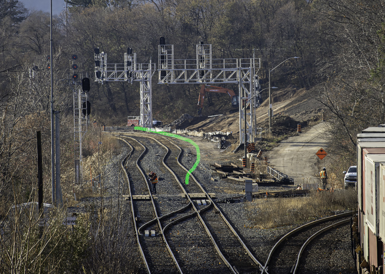

A shot of activity today at Bayview - looks like the turnout for the new third track to West Harbour is ready to be installed. Then comes the tracklaying. So nice to see this coming together. I'm told they may straighten out the kink in the tracks while they are at it.
The earthmoving on the north side that was commented on previously simply appears to be easing of the slope of the bank. I wonder whether new fencing is about to appear.

^ Just out of curiosity, why wouldn't they try for something like this? I assume there's a civil engineering reason relating to switch angles? Maybe even signaling? It's just tempting to draw a straight line extending the soon to be built third track cc @smallspy
^Without measuring clearances or curves, that alignment would be exactly what CN would not want. The whole idea of the crossovers is to keep GO on the south most track, and to minimise conflict between those movements and London-bound trains (whose route diverges to the right).
The track alignment at Burlington and Aldershot is all about keeping freight on the north and GO on the south. This aligns to that.
^Just to illustrate my point - just a few seconds after I took the above picture, this happened. See how CN relies on having both of the two London tracks available much of the time. There is a route possible from the middle track towards Hamilton, and that's used regularly by GO and Amtrak, if CN traffic permits. But running GO on the northmost track, and having it cross over in front of that eastbound, would be undesirable. That's why GO crosses over to the south at Burlington West and stays there until clear of the Dundas Sub.
On top of what Paul wrote, there is also a geometric reason why they won't do that.
Doing so would require the second switch to be a curved wye switch, which is not something that CN normally keeps in stock. Because it is non-standard, maintenance will be a bit more of a pain. As an additional minus, it's geometry may not be ideal for the speeds that CN wishes to operate at.
