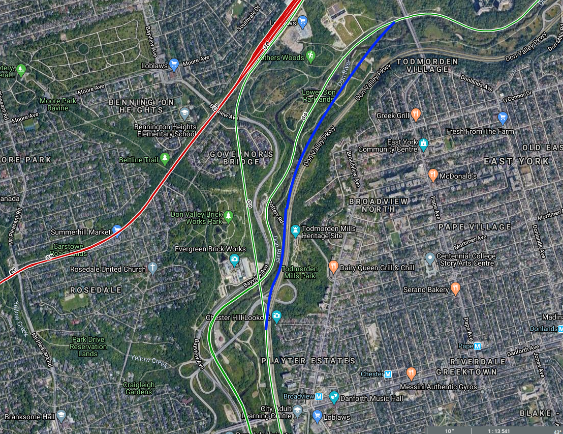

So a route similar to this? See the blue line. How far north would it go before it would meet back up with the Richmond Hill line?

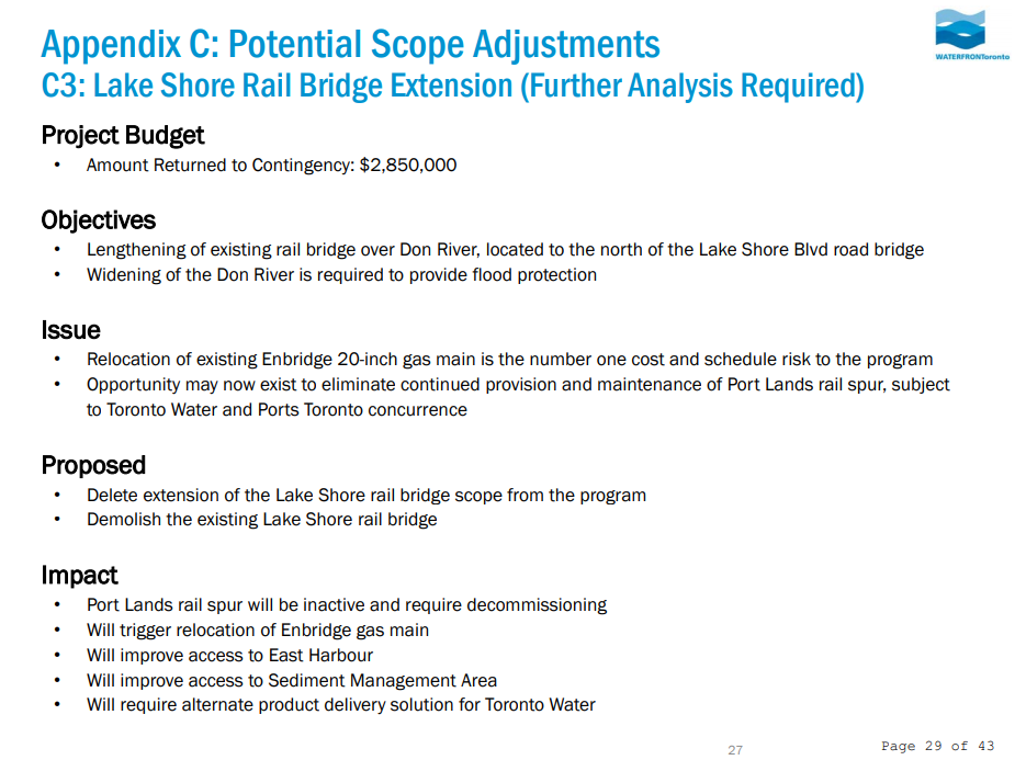

This may be related to the apparent move to abandon the Portlands/waterfront spur

@Allandale25 I would think they would want to hug the DVP all the way round to the Leaside Bridge if only to keep down the number of river crossings. The Ontario Line Don Crossing could influence available options too.
I never saw a map, and I don't know how far along conceptual modelling was ...........
From discussions with various parties, my impression was that the tracks would reconnect into the existing Bala not that far north of Pottery. In my head, I was thinking where the alignment is close again, 200m or so north of Pottery.
But as I said, I never saw a drawing, formal otherwise.

This may be related to the apparent move to abandon the Portlands/waterfront spur and the associated rail yard. There is clear talk about improved access to the Unilever site, which would imply no tracks at all north of Lakeshore, east of the Don.
To the best my knowledge, there are no plans to abandon the Portlands trackage. Indeed, that decision would rest on Ports Toronto and whatever they have planned for the area, and not Metrolinx.

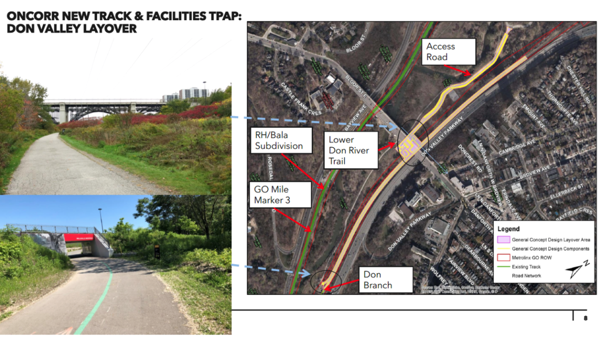

I don't know if that prospect is "on" or not....but..... it might align to what Metrolinx will show at the upcoming TPAP meetings ie a new layover facility on the Don Branch. Hard to tell if there would still be a thru track. The below slides were emailed out by the Riverdale South residents for a presentation that was recently given prior to the TPAP meetings.

A train yard under the viaduct. What's that squared area in the above image, right below Danforth...a parking lot? Sometimes it seems like large projects come right out of the blue. Wasn't it a year ago that a new and mammoth Oriole station proposal came out of nowhere.
