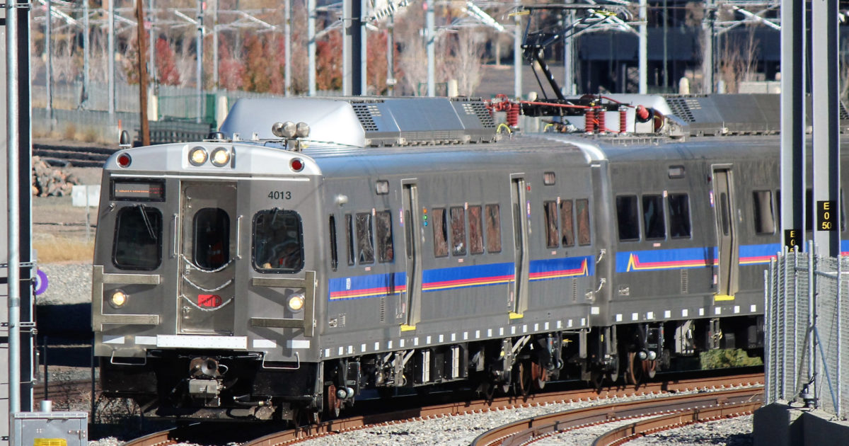

So what standard EMU rolling stock exists in North America today? There is the Arrow cars and and multilevel cars from Bombardier. Anything else?

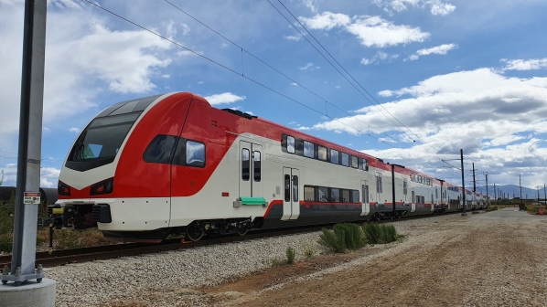

There's the Silverliner V for Philadelphia's Regional Rail and Denver's Regional Rail and the soon to be Stadler KISS in San Francisco for CalTrain. (Not my Photos.)

Like Caltrain, the rolling stock will probably be non-FRA compliant with an exception from Transport Canada, since the EMU's will only travel on Metrolinx tracks, and never CN or CP tracks.
God that's an ugly rollingstock. I don't get why NA (in particular U.S. transit agencies) put so little regard in the aesthetics of their EMU/DMUs. I know it ultimately serves the same purpose, but perhaps having a nice European/Asian rollingstock design might actually generate more ridership?
Its about Transport Canada regulations. Asia/European rolling stock is not allowed on mainline tracks here, even if those tracks are rarely if ever used by freight. That includes GO tracks. Hence why the UPX DMU is so big and bulky, it has to be built to FRA/Transport Canada standards to survive a crash with a freight train.
Exceptions are allowed but they are very specific and generally only on spur/branch lines like what the O-Train in Ottawa uses, or the ION LRT. Freight is only allowed at night while the LRTs and DMUs are sleeping.
Transport Canada is still concerned with EMU's sharing track with VIA rail and large bi level GO trains. They usually want complete separation from them, never allowing them to operate on the tracks at the same time.
So most agencies just end up complying with the TC/FRA regulations, its just easier, and you end up with this big bulky ugly super heavy and slower trains.
