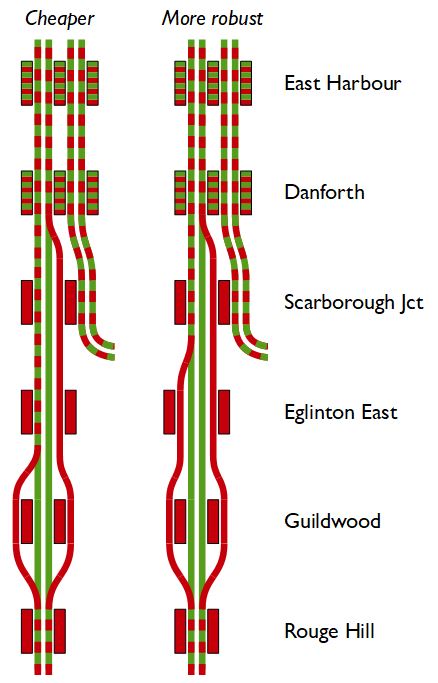

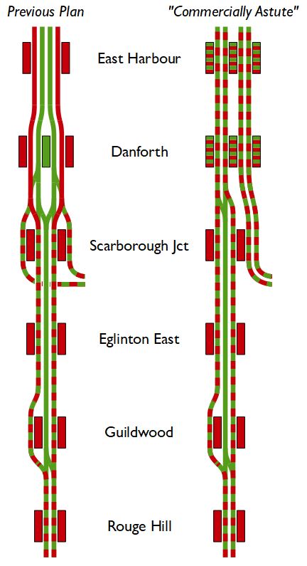

Here's my take at illustrating the changes he described: no more grade separation at Scarborough Junction, and an extra platform at East Harbour.
Rather than a single quad-tracked line with services sorted by speed, there are now a pair of double-tracked lines. This creates a problem for express trains, since they can no longer overtake local trains. This is the real reason that Verster's new plan has express trains stopping at East Harbour: they're stuck behind locals anyway so they might as well stop.
On the Lakeshore corridor, there is a pre-existing triple-track segment between Scarborough Jct and Guildwood, so there's plenty of room for peak-direction express services to overtake locals. But if we want express service all day in both directions, we're in trouble. In the absence of passing tracks (e.g counter-peak), the speed of the express services is dictated by the frequency of local service. With local service every 15 minutes, express services can only be about 7 minutes faster than the local. I'm assuming a minimum scheduled separation of 4 minutes, based on the schedules here in the Netherlands. So the express departs 11 minutes behind the local, and by the end of the shared segment it's 4 minutes behind.

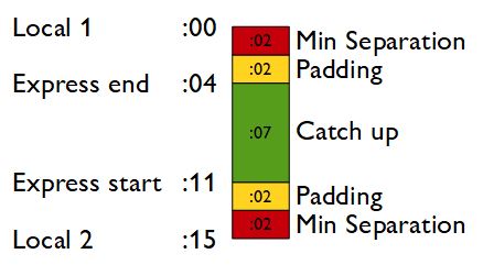

Even with moving-block signaling which allows trains as close as 60 seconds, a single shared track would still only allow the express to be 9 minutes faster than the local. But realistically we'd want express services to skip 5 or 6 stops between Union and Pickering, which would make them 10 to 12 minutes faster than the locals. And VIA trains are even faster still.
So if we want all-day express service in both directions, we need to build some additional passing opportunities. The cheapest option would be to simply add a fourth track at Guildwood station. The station's reconstruction a few years ago already built the structure and platforms for a fourth track, all that's missing is the track itself. But the downside of having a one-station-long passing track is that the local trains would need to sit for 2-3 extra minutes to allow the following express train to catch up. This delay can be resolved by extending the passing track to include another station. In the diagram below, I show the track being extended to Eglinton GO, but extending it to Rouge Hill would work as well.
The Stouffville line doesn't have any passing opportunites at all for express trains, so given that local service is proposed to operate every 10 minutes, express service is now physically impossible. In the previous design, express trains could run non-stop from Kennedy to Union.

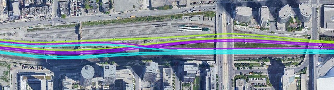

Another question is what this reorganisation does to the USRC. The current layout of the flyover west of Union allows westbound lakeshore/stouffville/barrie/kitchener trains to generally head through the middle of the corridor, while eastbound trains hug the southern edge. Between them there's room for services to terminate and head back the other direction, without crossing the Lakeshore local services.
Cyan: eastbound lakeshore/stouffville/barrie/kitchener
Magenta: westbound lakeshore/stouffville/barrie/kitchener
Black: turnback platforms (VIA, terminating services etc)
Light Green: other (UPX etc)
<--- toward LSW, Milton, Kitchener, Barrie | | toward Union Station --->
With both directions of Lakeshore service hugging the south side of the corridor, VIA's Windsor, Ottawa and Montreal services would either need to cross westbound service at-grade to reach their current platforms, or they would need to depart from platforms 24-27, which aren't directly connected to the VIA concourse.
Rather than a single quad-tracked line with services sorted by speed, there are now a pair of double-tracked lines. This creates a problem for express trains, since it is no longer possible to overtake local trains. This is the real reason that Verster's new plan has express trains stopping at East Harbour: they're stuck behind locals anyway so they might as well stop.
On the Lakeshore corridor, there is a pre-existing triple-track segment between Scarborough Jct and Guildwood, so there's plenty of room for peak-period express services to overtake locals. But if we want express service all day in both directions, we're in trouble. In the absence of passing tracks (e.g counter-peak), the speed of the express services is dictated by the frequency of local service. With local service every 15 minutes, express services can only be about 7 minutes faster than the local. I'm assuming a minimum scheduled separation of 4 minutes, based on the schedules here in the Netherlands. So the express departs 11 minutes behind the local, and by the end of the shared segment it's 4 minutes behind.
But realistically we'd want express services to skip 5 or 6 stops between Union and Pickering, which would make them 10 to 12 minutes faster than the locals. Even with moving-block signaling which allows trains as close as 60 seconds, a single shared track would still only allow the express to be 9 minutes faster than the local.

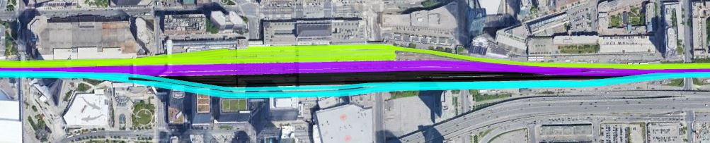

great diagrams, however in the Scarborough junction flyover, they had lakeshore and Stouffville trains stopping at Scarborough, as it an important transfer node for people that want to head south then east to Pickering instead of union. Do you think Metrolinx would have Stouffville bypass Scarborough station?
Yes I think Stouffville trains would skip Scarborough because its catchment area is the same as Kennedy's, and the latter has infinitely better connections. The single Stouffille Line train per day which used to serve Scarborough Station simply did so because otherwise there would have been a really long gap in service between Union and Scarborough due to the way the Lakeshore East express trains were scheduled. Saving four minutes for the small number of people transferring from the Stouville corridor to Lakeshore East would not outweigh the two minutes added for the vast majority of passengers heading through along the Stouffville corridor
^I'm not so sure that both lines need to stop at Danforth, either, given the ability to transfer in several directions at the East Harbour hub. Anyone from Stouffville wanting to transfer to Line 2 would do so at Kennedy. That might give VIA some better speed if they do decide to go through Kennedy with HFR.
I seem to recall that ML is indeed building a short length of triple track around Rouge Hill.
