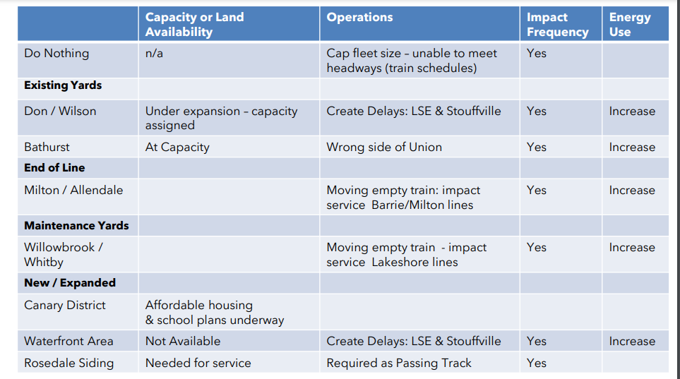

Precisely the opposite. The entire point of this project is to save [taxpayers'] money by reducing the amount of out-of-service train operations, and reducing the number of at-grade conflicts which could create delays. If money were no object, GO would just deadhead trains to all the way Willowbrook or Whitby, and schedule enough time for the not-in-service trains to eat any delays resulting from at-grade conflicts. There is not enough capacity at Bathurst, and Don/Wilson yards to store the entire difference in capacity which will be required between peak-direction and off-peak services. Whether that be trains providing extra frequency, or train units providing extra consist length during peak periods.

Is there not enough space in Wilson yard and lower Don Yard?
There's no real answer to this question because if money were no object we wouldn't need any of the yards at all. We would just run exceedingly long trains all day even when they're not required. It's a sliding scale of how expensive you want GO train operations to be.

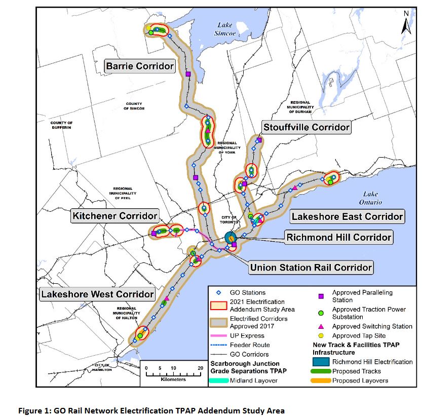

I can't seem to find quickly confirmation of this online from Metrolinx, but Steve Munro wrote in a June 2021 post that he believes the Don Valley Layover will be used for the Milton Line trains which will remain diesel.
The Don Valley Yard will probably host diesel trains from the Milton corridor which is not planned for electrification. The Bala Sub storage area will probably host trains from the Barrie corridor which will be electrified. From a servicing point of view, electric trains do not require wayside power as an alternative to running the diesel engines. However, that only eliminates one of several problems with the Don Valley Yard plan.
Metrolinx noted in a June 2021 presentation why the Don Valley Layover is needed.
^The intrusive part of the yard is not the choice of motive power - if diesels, they would be shut down while laying over, and if electric, there is still the OCS intrusion.
The intrusion is the addition of service buildings and roadway where it doesn't exist at present. That infrastructure makes it more than just a parking spot for trains.
Personally, I think it's an unnecessary choice at the expense of the greenery of the valley - there is likely room to squeeze three trainlengths of storage just up the road at Leaside - but the trackage needs to be retained against possibly VIA HFR and possibly a rethink of the Richmond Hill line (which will be an exercise in NIMBYism if it ever happens). The rail row should not be surrendered to parkland, and there will always be the necessary separation of trail and rails.

My statement was based on the fact that Metrolinx specifically added "Richmond Hill Electrification" as part of their recent New Track & Facilities TPAP.
I assumed that it was leading to the Don Valley Layover, but if there is a new Bala sub layover then it could be leading there instead.
