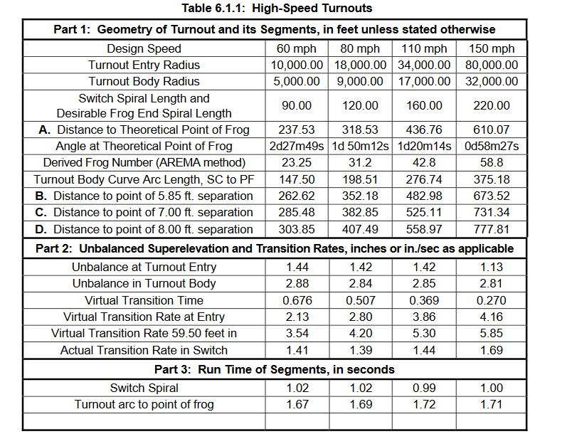

Here's list of some North American turnouts and their speeds:
Here's the more complicated math, which I will leave others to explain:
The above is from : https://hsr.ca.gov/wp-content/uploads/docs/programs/eir_memos/Proj_Guidelines_TM2_1_3R00.pdf

There are two additional, higher speed sizes that have been standardized by AREMA and Amtrak: #27.6 and #32.7. These allow for 60mph and 80mph, respectively, when configured as crossovers.
And there are higher speed standards used elsewhere in the World, but their geometries are suspect in the North American sphere of operation. There have been ongoing tests with different geometries at the AAR's TTC in Pueblo, with some showing some promise. Those turnouts listed in the image linked above were originally shut down by the FRA, before stepping back upon the introduction of testing at the TTC.
