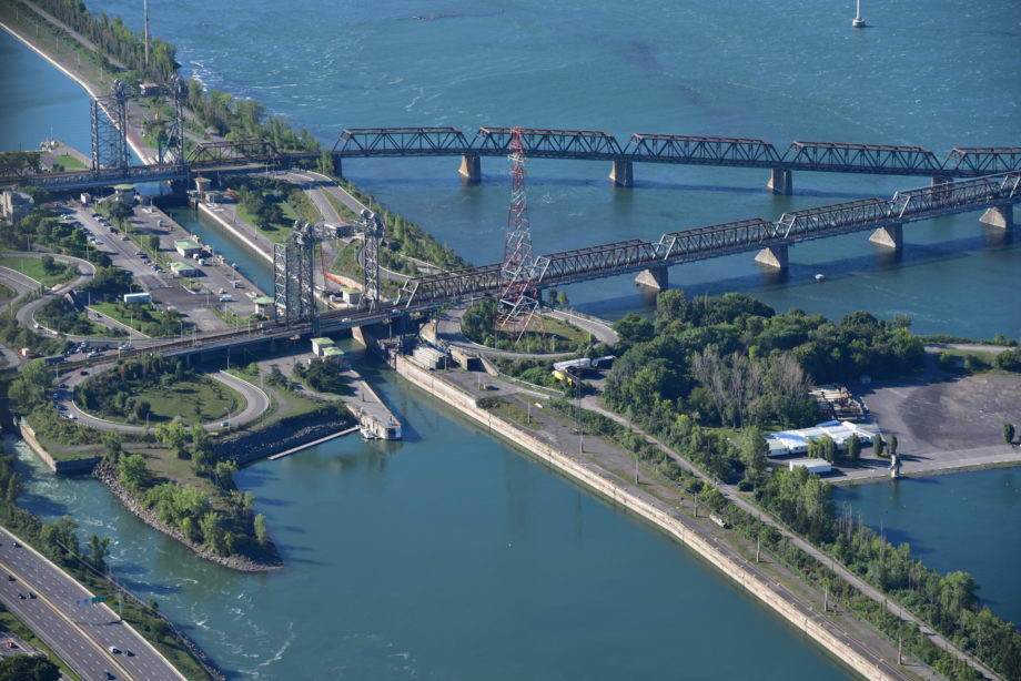

One solution to the TO Transit Welland Canal crossing I have not seen mentioned is that of the Victoria rail bridge over the St Lawrence Seaway. The rail line has two paths over the seaway lock, one at each. When a ship is entering or leaving the lock at one end, trains take the path over the other end of the lock - and vice versa. The result is only limited, if any, disruption to rail service - a combination of CN freight, VIA Montreal to / from both Quebec City and the Maritimes, as well as EXO local commuter trains
From an initial look at the area of the CN rail line crossing the Welland Canal, it appears that this might be a feasible approach, with maybe only limited acquisition any already improved property.
I don't think that would work for GO service the way you intend. Locks 4 to 6 of the Canal are twinned, unlike the St. Lambert lock. The locks are half the width of the canal, and so that stretch has two sets of locks, side by side, to allow ships to pass. There are actually 6 locks in that stretch technically, so under your plan, a northbound ship could keep one bridge raised, while a southbound ship kept the other bridge raised.
(EDIT: A second bridge would help though if there was only one ship passing at the time you wanted to run a train. I'd have to look more deeply into canal traffic to see how often ships use both sets of locks simultaneously.)
Wow, I've been over that bridge as a driver, and occasionally by rail, and I'd never realized that was what was going on. I guess that explains the extra car lanes too.
I guess I've never driven across when the bridge is open. Or considered this possibility.
Thanks for posting, I can't believe I missed that! Looks like a plausible option for Welland. The land is available. It would be interesting to see the business case for tunnel versus bridge versus this kind of option (is there a word for this?).
This is a unique solution, thank you for posting. But I think its benefit is limited in the St Catharines context, given it's twin-flight locks, i.e. two points of shipping disruption. I still think a tunnel is a way to go because...
