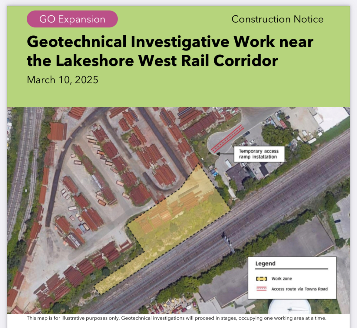

This construction notice says they are doing some work on the Burloak Drive Grade Separation this weekend.
(EDIT: They are also scheduled to start replacing the Drury Lane pedestrian bridge this weekend.)
