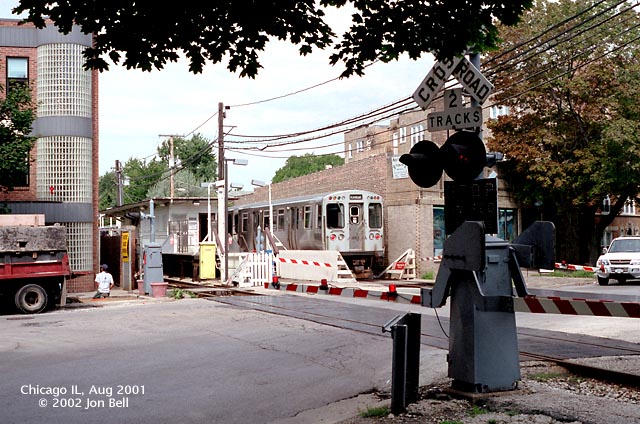

Due to RER, at least initially, not being completely grade separated for the entire 200km, 3rd rail is NOT, optional, Full stop.
Anyone who thinks differently I encourage them to go their nearest subway station and walk across the tracks and see if you make it across to the other side. There is a reason why there is no such thing as 3rd rail streetcars or LRTs, ANY contact with someone means they fry.
3rd Rail LRT
3rd Rail Streetcar
3rd Rail RER with grade crossing
3rd Rail Rapid Transit grade crossing
They exist, and if you had to electrify GO with 3rd rail, you could, it would just be a huge non-starter and would be insanely inefficient. However, it'd still be more practical than full Hydrogen or Battery electrification.

I would say that the London Docklands line counts more as a grade-separated light metro line similar to a traditional subway, whereas the latter two (MTA and Chicago) really count more as legacy systems full of compromises that would not be built as-is today.
Only the ground level power supply could be considered, and even it's for streetcar loads, not full mainline cars- and more for aesthetic rather than efficient reasons.
