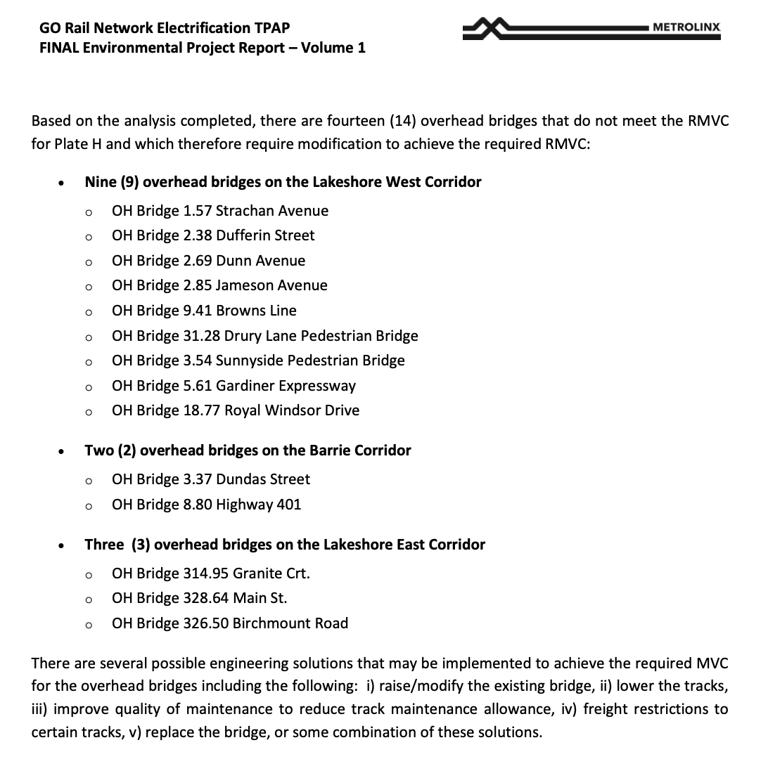

Are the tracks for Lakeshore East and West on the south side of the train shed? (outside the train shed) - Would it not be possible to electrify these newer tracks without worrying about the constraints of the shed? - I also think it might be time to talk about removing the train shed! I had high hopes for its rehabilitation, but I don't think it looks great imo... not to mention, its impracticality on greater Union Station electrification. For the record, I do like the loop idea! - works great in Sydney and Melbourne...
This appears to be the plan. Whether the trainshed is altered or not will not prevent ML from wiring up the new south platforms for LSE/LSW ahead of electrifying other routes.
Now, getting those low bridges on LSE/LSW fixed is another matter...
Would the fix the bridges themselves or slightly lowering the grades? I think I remember a report from years ago that I may still have that spoke to what would need to be done. Maybe I can look it up.
My recollection is some of Collumn A, and some of Collumn B,
Here's one study for Dunn/Dowlling, no mention at all of electrification - which would undoubtedly impact on design.
PS Dufferin
PPS - Considerable bridge by bridge discussion in the Electrification EA beginning at page 147ish of the EA Report, Volume 1
PS Dufferin
Can we ask if the required change(s) are strictly clearance levels for wiring, and if so, do we have the data on those problem clearances as well? All of this is a problem. However the issue in meters is one thing, cm's may be another.
