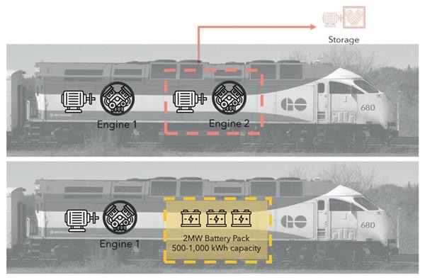

This concept design makes no logical sense imo. Why do they keep insisting on reinventing the wheel when Dual-Power locomotives already exist that can meet the needs for all lines and Union Station? Both Siemens and Alstom already make models for the North American passenger rail system that would meet the needs of GO both pre and post-electrification. Especially since long-term plans include running more frequent but shorter trains anyways.
It might make no sense in a lot of other settings, but it might well make sense here - considering that this is a testbed and not a decision to replace the entire fleet.
It makes sense thanks to having lines that need to coexist with freight landlords who are opposed to wires and also likely skeptical about the prospect of all-battery trains blocking their lines when the battery fails.
And it makes sense as an experiment with a fleet that might not be totally at end of life - those newer offerings come with their own power sources and parts aupply and learning curve. A hybrid that sticks with the known and maintainable diesel and control systems is less to swallow.
Plus I would challenge your claim that new models are actually out there for the taking… can you cite a single property where they are out there in production service ? Sure vendors will offer them, but ML would be unwise to go out on a limb as the first to bite.
A single test bed relying on what ML knows best makes a lot more sense for now.
