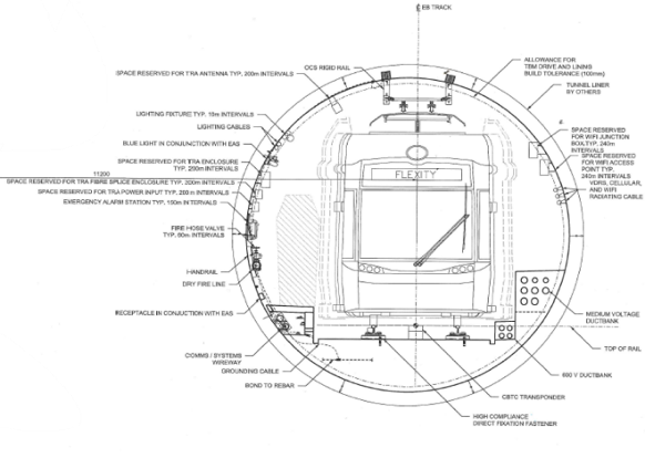

Where did you see that Eglinton won't be using catenary in the tunnels?
I looked at the tunnel bore size. Catenary inside a tunnel is relatively rare as it requires several feet of clearance (even for 750V DC lines) above the free-hanging wire. The electrical feed for Eglinton will be a non-flexible rail bolted to the ceiling in some way.
Ninja Edit: Catenary is a shape describing a non-stiff wire/chain hanging between 2 points (at various tensions). If it doesn't make the shape, then it's something else and you cannot use "catenary" equations to calculate where it sits at any given point along the way; clearances need to be calculated another way.

I'm curious, is the diameter of that tunnel large enough should the Crosstown Line become heavy rail for TR trains?
It's an excellent question! And the answer, depending on which "loading gauge" used, is yes! Paris RER with double-deck trains, the type that move more passengers per hour on a double track than any other commuter line in the Western World (perhaps even the world) is slightly less diameter (bore width) than Crosstown.
Let me take your question further, to intuitively answer where you're going with this: The Downtown Relief Line, for instance, could use the TBMs being used for Crosstown (once refitted) to bore a tunnel that could run RER trains in the future, and through-running onto the rest of the RER network later, and LRVs now until tunneling allows through connection to the extant GO lines.
The major differences being station length needed for longer consists typical of RER, but being low platforms, which are easier/cheaper to provide, and the LRVs being either bi-modal current (750VDC/25kVAC) or straight 25kVAC to run on RER tracks. Paris has a line doing just that, as do a couple of other cities.

The tunnel diameters on Eglinton are larger than subway.
I haven't seen anything that precludes them building platforms in the stations for subway trains. Though the escalators would require some modification.
