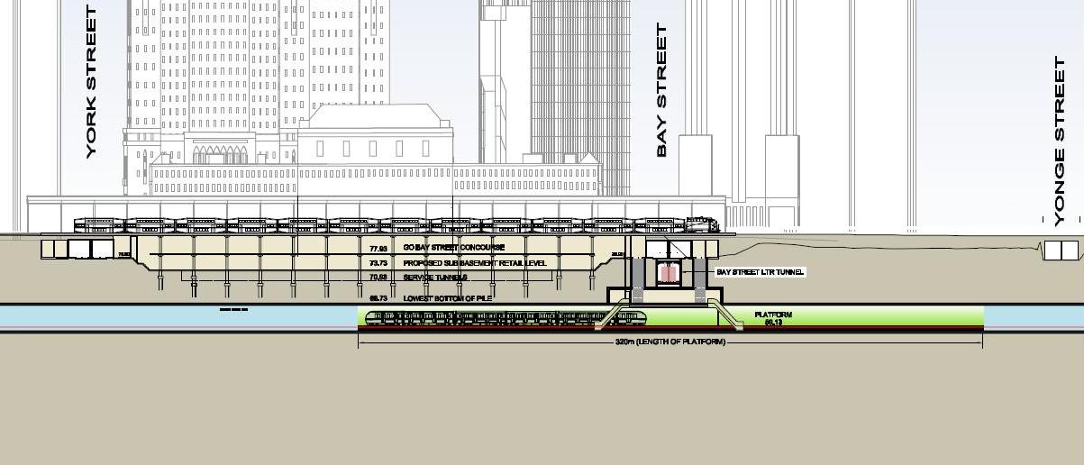

Probably the most critical piece to make all of this work is the tunnel under the Union Station Rail Corridor to run RER service.
I don't think such a tunnel would really be needed for a RER network. Union should have plenty of physical room to accommodate new services. The assumptions which lead to USRC Capacity Study to suggest a new tunnel or terminal station seem questionable and in any case undermine the entire point of RER networks (high frequency 'through' routes).
Paradoxically, we may need to reduce the total number of platforms at Union to create wider RER platforms with better vertical passenger circulation.

Basically, the cost to add a tunnel under Union would start at 1 to 1.5 billion and go up from there. It's really quite a lot of money to double down on a corridor which is quite wide as it is. If there ever was an unavoidable capacity constraint (which I don't believe will happen in our lifetimes), the solution would be to start offloading the Intercity and Regional trains somewhere else (a new North Toronto Station?) where they could sit for longer without displacing trains serving much busier local routes. If space really is at such a premium at Union, then it should be catered to routes with the greatest ridership potential which means 'local' routes.
Didn't the complicated nature of the pilings below the rail corridor through Union pretty much make relocating of tracks in the shed an impossibility? Someone is going to have to elaborate here, since I'm not exactly sure where this came from.
