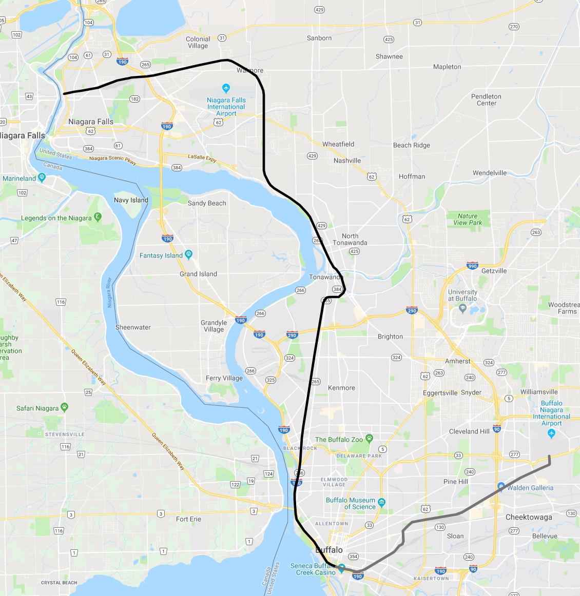

Honestly... If we need to test Hydrail in the GTA writ (ridiculously) large, how about Buffalo?
But seriously, aside from the attempt to turn this into a Canadian technology project, commuter rail makes a lot of sense in the Buffalo - Niagara Falls corridor, Buffalo's got the same advantages as a test site as Toronto, the service would be on a much more manageable scale than anything needed here and the new FRA rules make the regulatory environment a lot more certain for the kind of equipment that has actually been looked at to date. It even ties in to GO nicely now we've got (sort of) full service to Niagara. I actually think this is a much better idea than trying to force this into GO at this stage.
For that matter, if you extend the thing east to the airport (on a corridor thats almost entirely abandoned trackbed) commuter rail, sold as electrified with hydrail, massively improves the prospects for getting the second Metro Rail line eventually built.
Instead of testing in Buffalo, why not hop the big ditch? Test Hydrail on LSW between Niagara Falls and Aldershot or West Harbour. I'm sure ridership doesn't justify a full 12 cars that currently services this section. It can run all day assuming CN pays ball and decouples the Welland Canal issue that is gonna start up in a few months.
