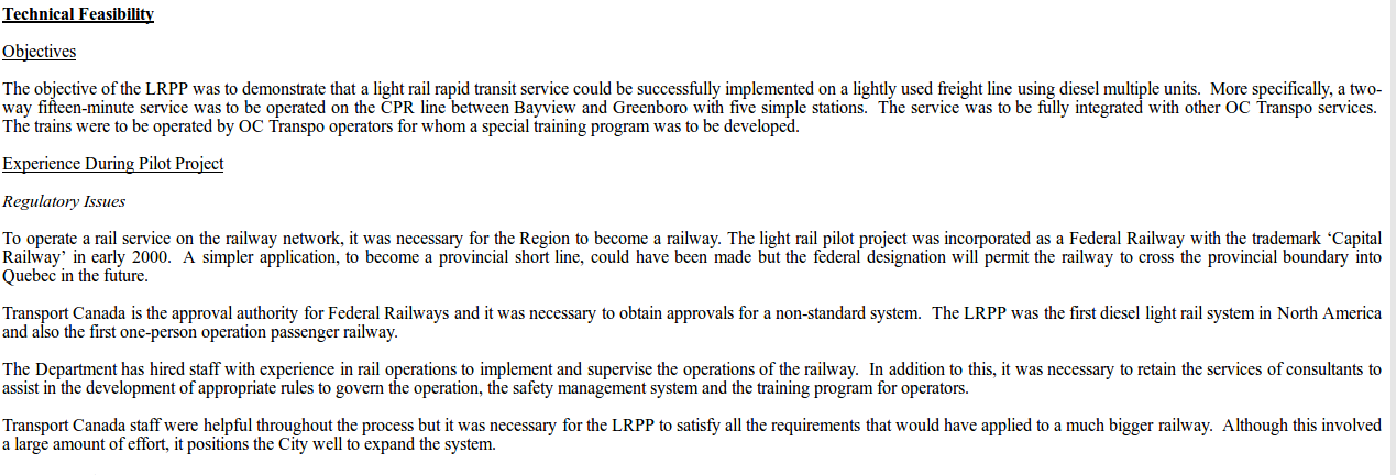

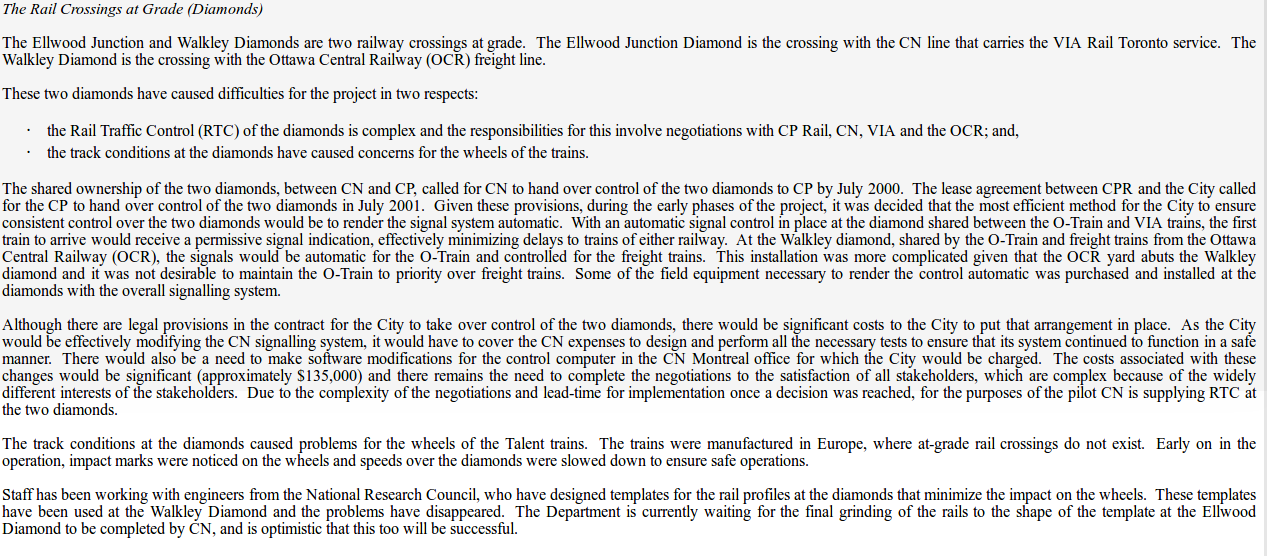

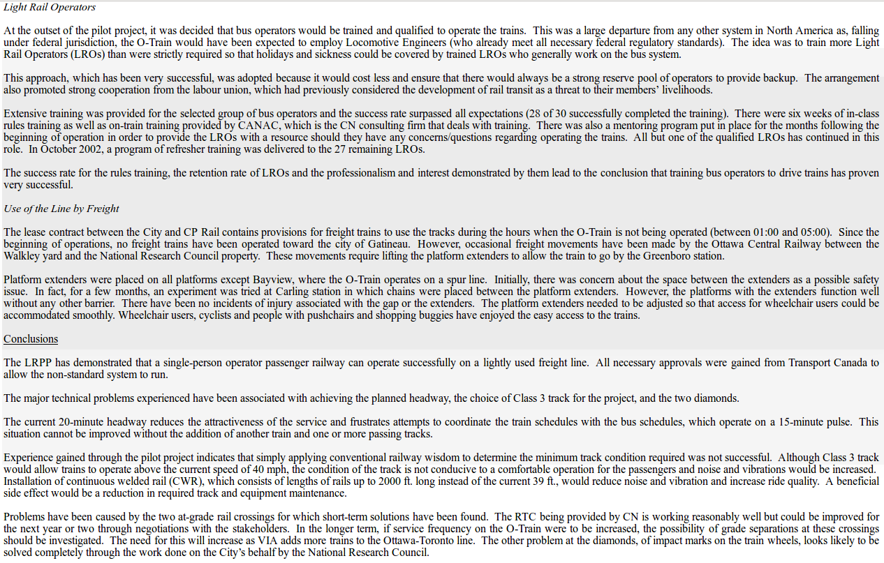

Copied from a post of mine in the Moose Rail string. This is how Ottawa got an exemption from TC regs (it helped that every federal department concerned was pulling for it)
http://ottawa.ca/calendar/ottawa/citycouncil/ttc/2002/12-04/ACS2002-TUP-TRN-0012.htm
First attachment above unfurled:
175974
Note:
Regulatory Issues
To operate a rail service on the railway network, it was necessary for the Region to become a railway. The light rail pilot project was incorporated as a Federal Railway with the trademark ‘Capital Railway’ in early 2000. A simpler application, to become a provincial short line, could have been made but the federal designation will permit the railway to cross the provincial boundary into Quebec in the future.
That's somewhat misleading as it applies to "The National Capital Region", and as such, under other Acts, federally regulated.
A unique and significant feature of the transit system operated by OC Transpo is that it is a “federal undertaking” and thus subject to a variety of federal labour laws and related legislation, such as the Canada Labour Code, and the Canadian Human Rights Code. This situation arises by virtue of the Constitution Act, which provides that the federal Parliament has authority over interprovincial modes of transportation. In 1983, the Ontario Court of Appeal confirmed that OC Transpo was a federal undertaking and therefore subject to the jurisdiction of the federal government. Further detailed information about the legislative history of OC Transpo can be found at Annex “A”.
