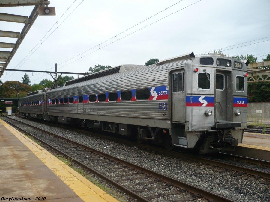

Depends on the rolling stock they purchase. Some trains like the Silverliners in Philadelphia have stepped access for low platforms and step free access for high floor stations. View attachment 167076

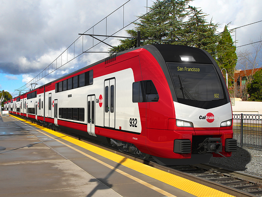

There is also the prospect of a dual level railcar, such as those KISS EMUs being ordered for CalTrain:

Those trains are horrible and would be nothing but trouble for RER. The hallways are incredibly thin as are the door. Just 2 wheelchairs would practically bring the entire exit/entry to a halt. If they are intent on having 2 levels then they should have complete 2 levels and not where you enter and then either go up or down stairs. The entry level should be completely open with subway style interior, exits, windows, bike racks, wheelchair spaces etc and then the second level should be more traditional RER/Commuter layouts for travelers going larger distances. Basically much like the current double-decker buses.

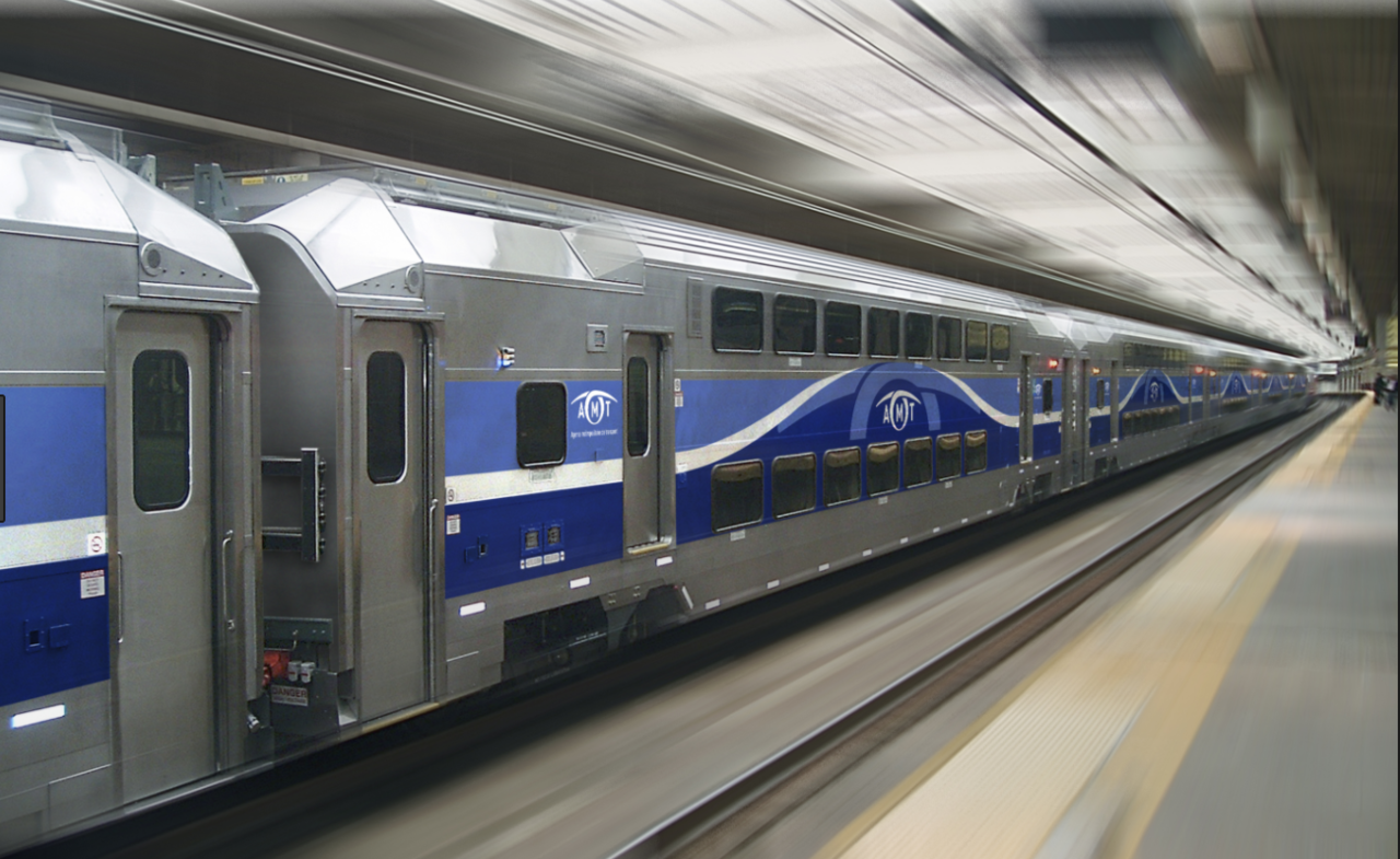

^Not that much different than the diesel powered version, which is quite well used in Montreal and NJ.
The amusing touch I noted in the video was the traditional clip on the seat backs for paper tickets - no high tech fare card/POP honour system on NJT!
I imagine a GO style bilevel fitted out as EMU would look much the same. Wonder how the relevant dimensions (Interior seat width, interior cabin height and width, aisle and door width) compare.

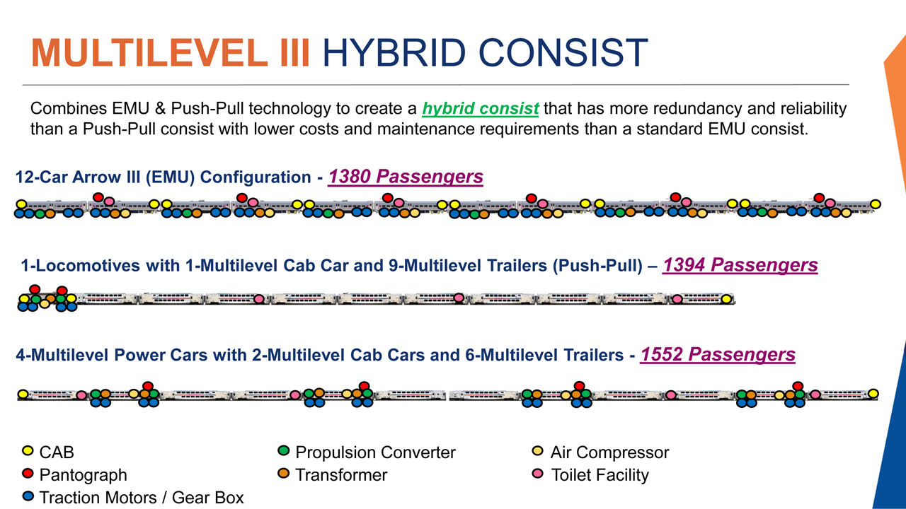

That would be very interesting and could potentially significantly lower the cost of electrifying the fleet?
I think so but I'm not sure. I don't know how much they are paying for those powered cars. The contract is valued at $670m USD for 58 power cars, 33 cab cars and 22 trailers. I don't know the price of each part.
