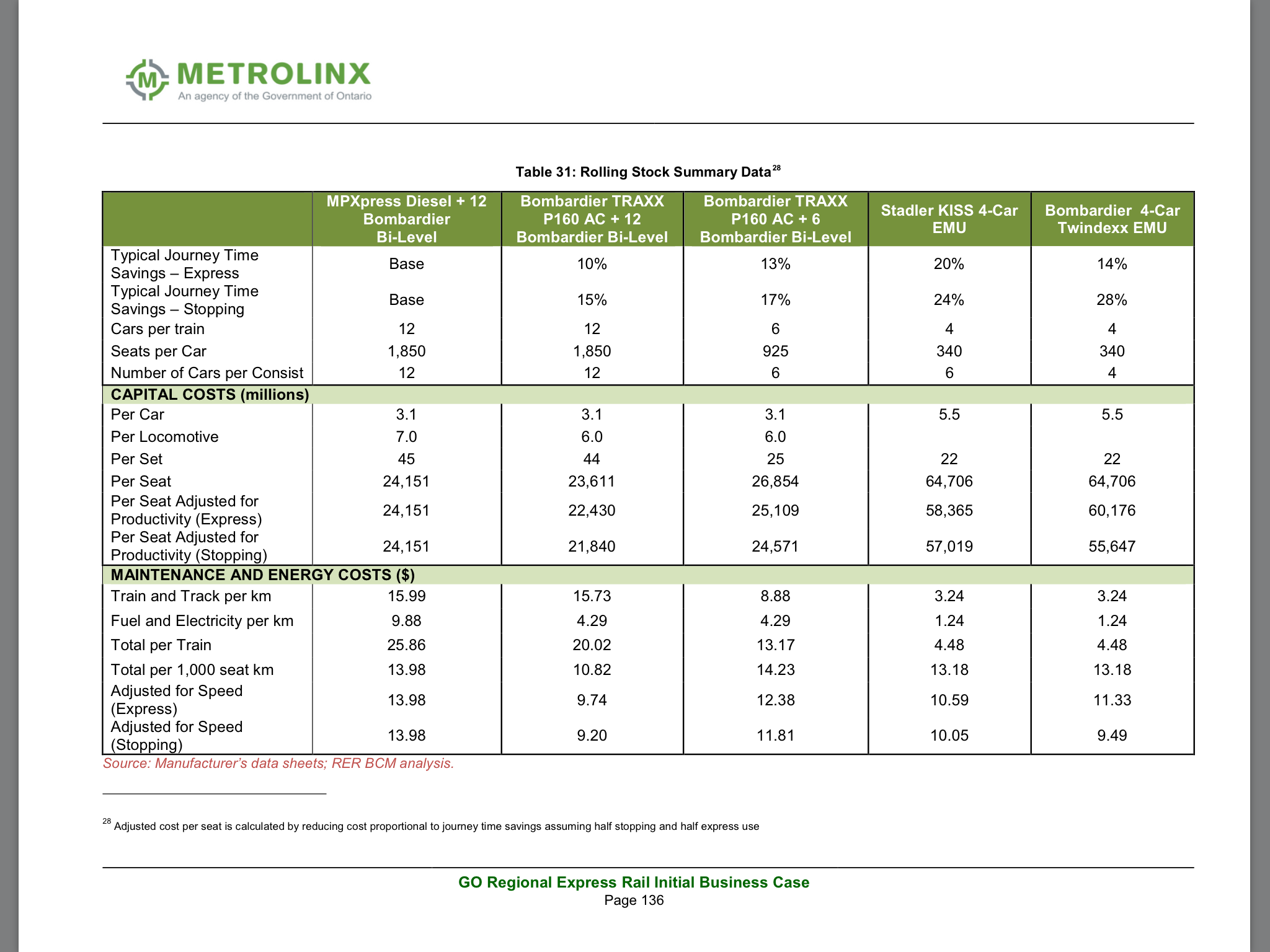

Ummmm.....hello. Stadler KISS is apparently one of the RER candidates:
(Not all submitted candidates listed.)
Ironically, some errors in this data. 1850 seats is per train and not per car.

That chart is pretty interesting, in the sense that it quantifies just how much of an economic penalty we pay by requiring the heavier TC/FRA compliant rolling stock. A 6-car Bombardier Battlestar-class bilevel train has many more seats, costs roughly the same, so is much cheaper to acquire on a per-seat basis. But - it is more expensive to operate and can't match the performance of the lighter and more compact alternatives, even spreading cost across all those additional seats.
I havent found a diagram, but photos certainly suggest that both KISS and Twindexx have a smaller cross section profile - making them lighter, but perhaps less spacious and less rider friendly upstairs.
If we assume we are moving to fast + frequent, we may not need the extra seating capacity.....but I wonder how 4-car train of traditional GO dreadnoughts might compare.....same seating, same passenger capacity.
