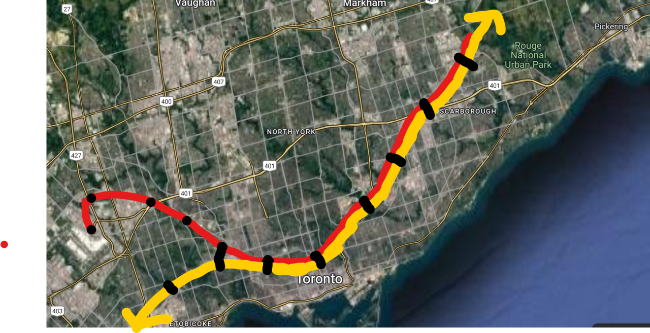

Regarding the Midtown corridor , I think that Potentially through running to Pearson (ie a Malvern-Pearson train in red) would be better for connectivity than running through running with the Milton line (yellow)
