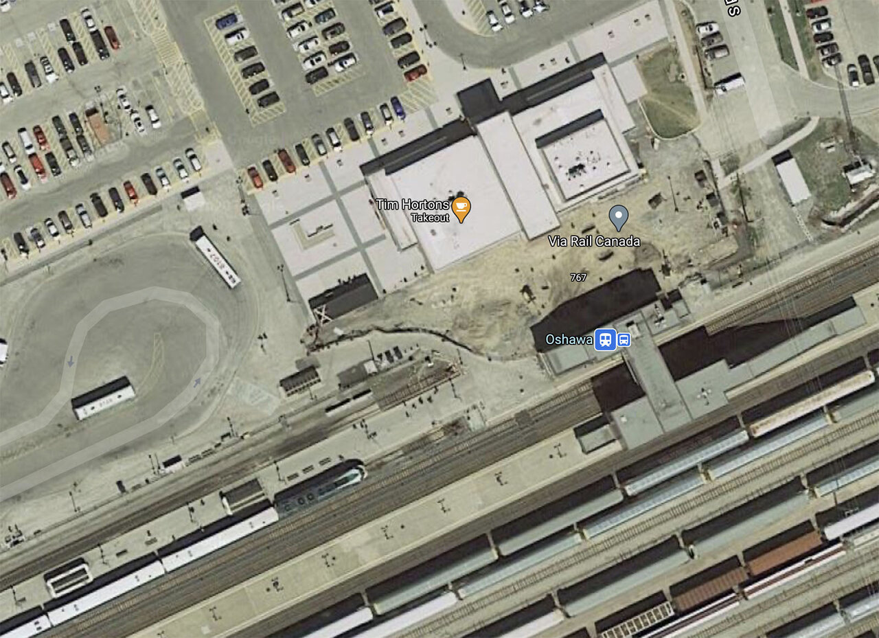

The UT server is not playing nice today, and the two images I had tried to post somehow got deleted. I'm trying again. You can see the gap that would be available for extensions, and you can see how the current stub tracks aren't very well aligned to an extension.

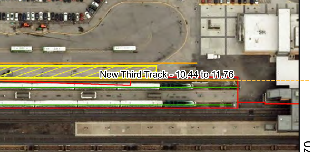

This could go under GO Construction, but I'll put it here since I'm going to refer to the Bowmanville Extension. I wonder if the drawing below from PDF page 40 here provides some insight for what may happen at the Oshawa Station for the Bowmanville Extension. Source: https://www.metrolinxengage.com/en/content/new-track-facilities-environmental-project-report
Dashed lined for the Extension added below. Not sure if a second track would extend under the new Oshawa Station platform bridge (picture here looking west towards the existing GO tracks).

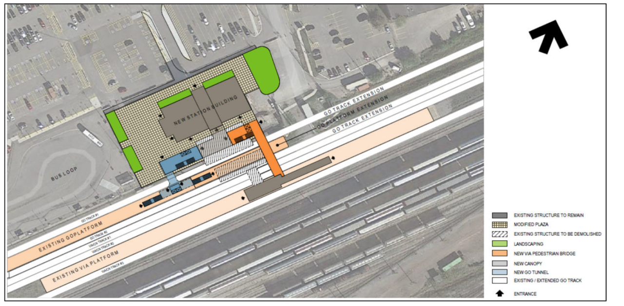

I'll correct my record again because I hadn't realized that the Bowmanville Extension IBC provided concept plan for the changes to the Oshawa GO Station. PDF page 81 here.
So with this latest track plan from the TPAP, it provides some guidance on what may happen at Oshawa. The only the the IBC drawing doesn't show is that new north platform and two stub tracks.

Existing structure to be demolished? They JUST BUILT IT! Seriously??? Am I missing something here? They didnt design the new Oshawa GO station to allow for the tracks to continue to Bowmanville??

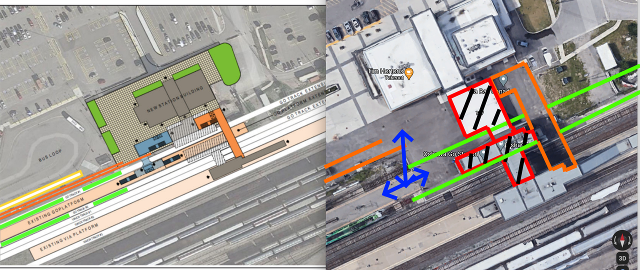

It doesn't look like to me the entire new GO Oshawa Station and platform bridges need to be demolished when comparing the TPAP plan and the GO Bowmanville Extension Option 2 (GM Spur) Oshawa Station plan.
It appears that only a portion of the north side pedestrian bridge structure would need to be demolished and rebuilt to the east, and the low hanging canopy. Given the small scale, I don't see the big deal in the bigger picture.
Here's a rough comparison I've done to a Google Map. Red shows what will be demolished, the orange structure to the right would be added for the bridge. Maybe they could even just reuse and shift the existing bridge. Blue lines are the tunnel under the extended track.
^Well, the VIA siding track has lost its platform, so it likely no longer has any purpose.... it's not that old. That's a waste.
The north stairs may be retainable, but the greyed out area does suggest the elevator shaft and stairways are both being moved. That's a waste of the original construction. I'm acutally surprised by that since, as you suggest, they could just build a second bridgeway in the orange area, and keep the existing structure.
To reuse the bridge, VIA would lose all access to its south platform while the work was being done. I'd say that's not doable.
^ Sorry, good point. The existing bridge isn't as long as what's needed (as shown in orange). So probably best to just create a new one.
