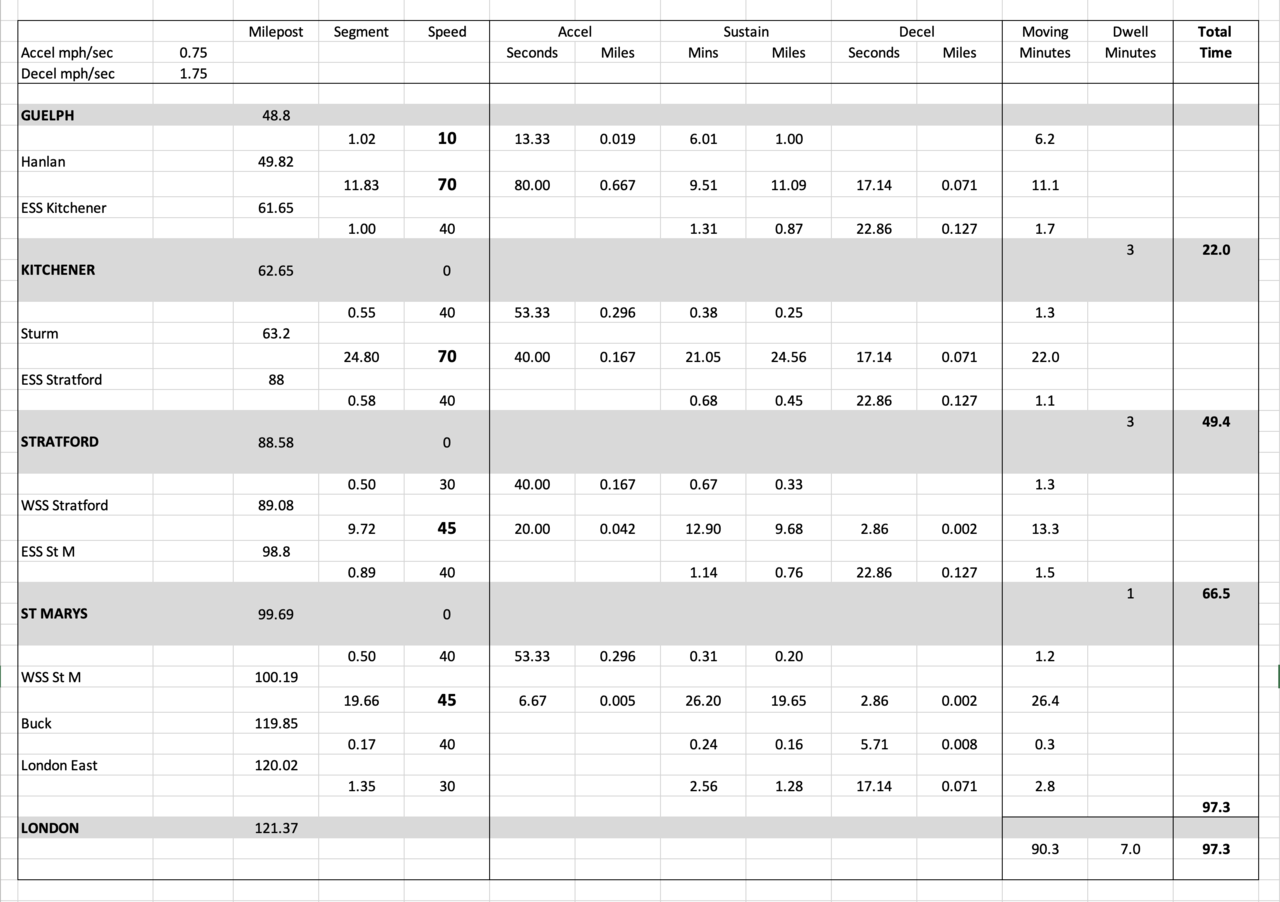

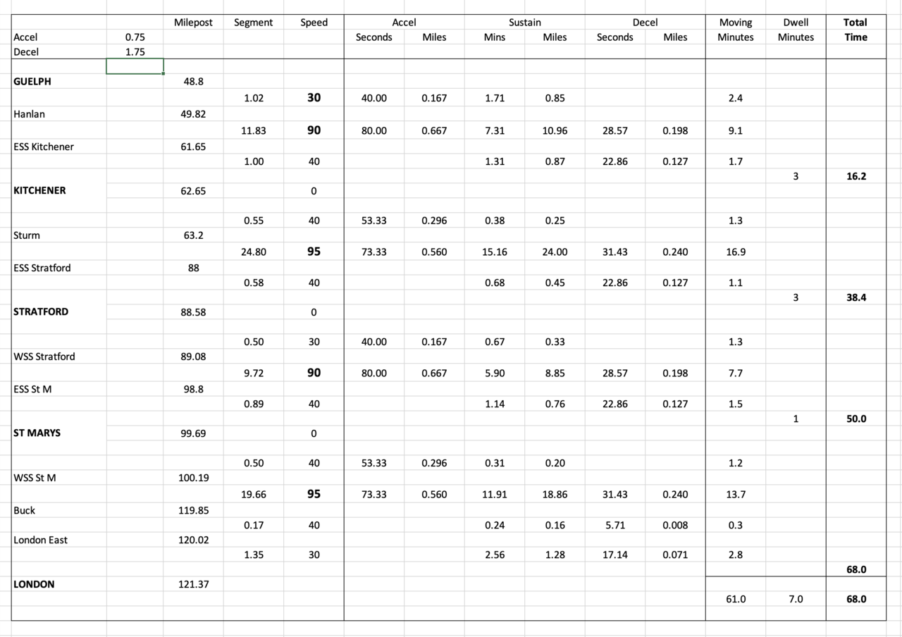

Just to illustrate how much better service on the KW-London line could be with a modest upgrade in the track speed, here are a pair of simplistic models of the current and potential timings. Consider them as "optimal" ie unpadded timings within the current signalling and track arrangement.
The first models timings given current track speeds. It gives a sense of why VIA is so slow on that line today.
The second chart shows the same data, but with modest speed increases. One does not have to build HFR-quality track to get very significant improvements in trip time. In fact, raising speed further in the model to 95 or 110 mph saves only a couple of minutes.
The only thing required to reach this level of trip timing is some very basic and straightforward track work - undercutting, tie replacement, rail replacement, surfacing, and crossing repairs. Maybe some bridge repairs. No issues with acquiring land, expensive civil works or grade separations.
Higher frequencies would demand a couple of new sidings, and that might add some meeting time to schedules, but you get the idea.
It is such a basic and fundamental bit of improvement that I cannot fathom why it is not being done. (nitpick - I included the KW-Guelph segment, which is being improved by ML)
Current performance
Potential Performance

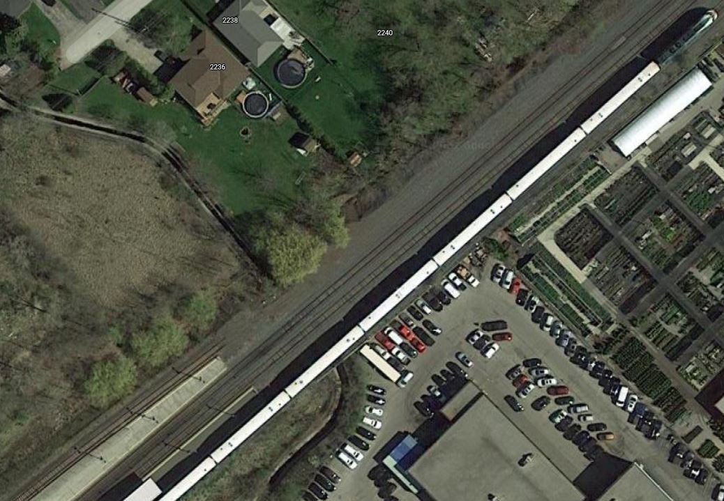

Kitchener's current station has horrible access by foot, bike and transit, so its potential as a destination is pretty limited. To access the station by foot from the northwest, I used to climb up the side of a grassy hill, push through some bushes, jump a guardrail and walk aross the parking lot, since the only official pedestrian route heads to the southeast.
Also note the desire line toward the intersection, since there's no direct pedestrian path from the station toward downtown Kitchener.
The new Kitchener Central Station will massively improve access by foot, bike and transit, making it a much more viable destination, assuming they ever get around to actually building it.
