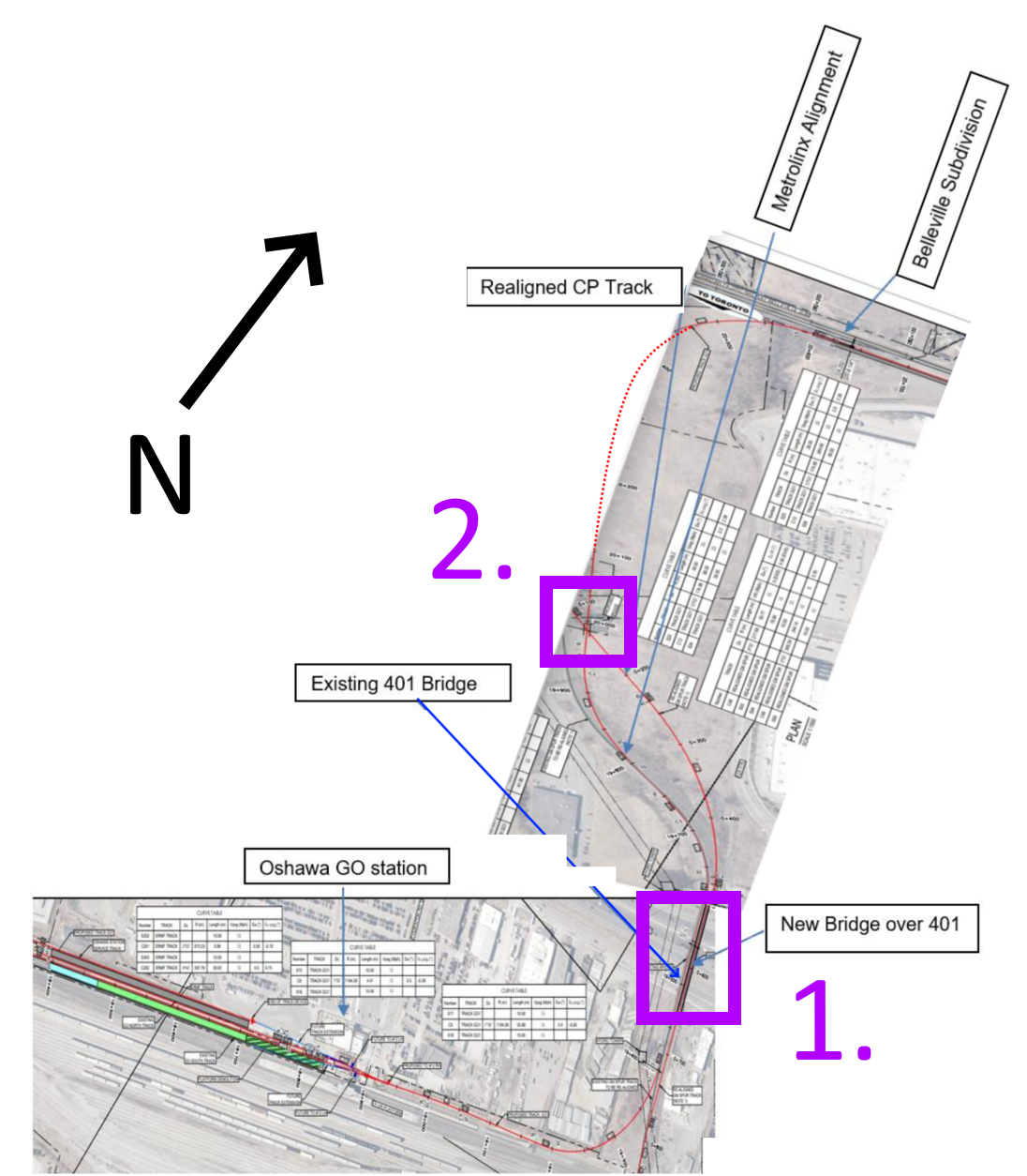

^ Probably related to the cost of the (1) new bridge over the 401 beside the existing CP GM spur bridge, and the (2) new rail-under-rail grade separation for the GO-CP GM Spur track?
Those are some tight curves. What kind of trains are supposed to be able run on those.
The existing fleet.
Luckily since this is before/after a station (depending on the direction you are going, and there is a new station before the second curve, you already have to slow down/accelerate out of the stations. So its not a huge deal.
^ I'm almost certain it's grade separated because Metrolinx said that the route could operate "independently" of CP Rail.
You can double check here. This was recently released as noted a few pages back.
Re GM spur:
https://www.metrolinx.com/en/region...nement-Technical-Memorandum-post-PDBC-V17.pdf
>New bridge to be constructed on the GM spur over Hwy 401 parallel to current bridge with grade separation between Metrolinx and CP tracks north of the 401
ya so it is separated

The existing fleet.
Almost a mile and a quarter at 15 miles per hour is hardly what I would call "not a huge deal". That's a quarter mile longer than the former PSO that Metrolinx just removed through Guelph.
