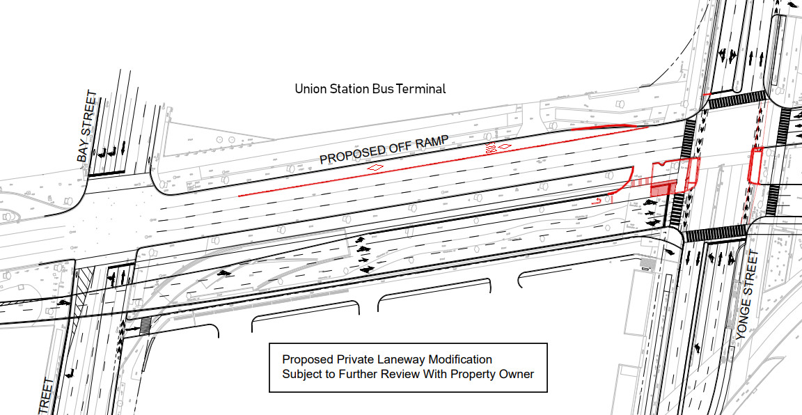

While I like the idea, I'm not sure that the grades would permit an early left-turn like that. Much like the Simcoe Off-ramp, the Yonge Off-ramp will be a steep downward grade meeting grade immediately at the intersection from my understanding. GO cutting across 3-lanes of traffic mid-block on a stretch of road that is often extremely congested will also be quite challenging.

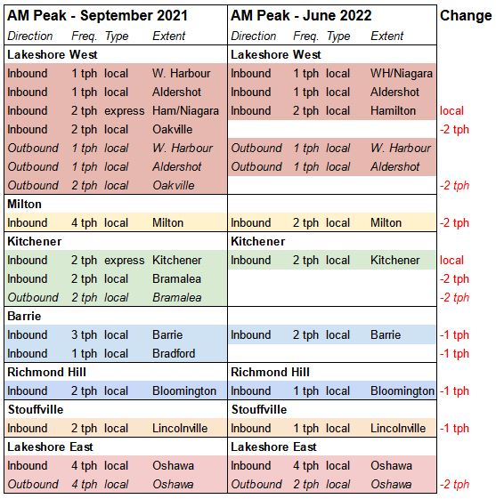

Regarding 10 car trains, what do you mean? GO right now is running a fraction of it's pre-COVID peak hour service with 10-car trains, there is an absolute ton of room to improve peak hour capacities before crowding becomes a problem again.
Could be. In which case the U-turn would need to occur in the intersection which is unfortunate from a pedestrian delay standpoint since the north half of the west crosswalk would no longer be able to display Walk during the eastbound left turn phase.
It would be a fully-protected turn, simultaneous with the north-south crosswalk. You just turn when you get a green arrow. In the City's proposed design, the westbound capacity at Bay has been increased (due to the additional lane), while the westbound capacity at Yonge has been significantly reduced due to the additional turning phases required (i.e. less green time for westbound Lakeshore). The gridlock will therefore be relocated a block eastward, out of this particular block.
They are running heavy 10-car trains all day on many lines, while for most of the day ridership does not require more than a 6 or possibly 8 car train. But if the train has been made 10 cars long, it means that there is at least one trip during the day which requires it. And I'd be willing to bet that that trip is at rush hour.
We're definitely not pushing against the capacity limitations of our infrastructure or rolling stock at the moment, as you mentioned. But the point is that big time-of-day spikes ridership have associated costs compared to more evenly-spread demand. In this case, the cost is that everyone on an off-peak train needs to suffer through the glacial acceleration of a 10/12-car train, even though those particular trips don't actually need the extra capacity.
Yes we should. It costs a rail system far more to add capacity during the peak hour than during other times, since that's the service pattern around which the tracks need to be designed. If you run 8tph peak and 2 tph off-peak your line needs to be able to support 8tph. If you can spread out demand to run 4 tph all day, you only need the infrastructure to support 4 tph, saving a lot of construction and maintenance costs.
In all of the office jobs I've ever had, people commuting by car have had wildly differing hours to avoid traffic, arriving insanely early or very late in the morning, while transit riders all showed up between 8 and 9. Because although rail transit gets more crowded, it doesn't get much slower so demand doesn't disperse the same way it does around road traffic congestion. Providing discounts outside of rush hour helps create an incentive to disperse demand around the peak periods.
Variable pricing goes a long way to making the system a lot more affordable to operate, and those savings could easily be passed on to the riders in the form of great off-peak discounts.
An alternative to official "peak" and "off-peak" prices are time-restricted discounts. For example, here in the Netherlands there is only one base ticket price, but for €5/mo you can get a NS subscription which gives you 40% off off-peak.
Or on the TTC, parking is paid on weekdays until the early afternoon, then free on evenings and weekends. So in effect if you're going to drive to the station, it's cheaper to travel outside of peak periods. This latter example would be highly effective on GO given what a large percentage of ridership drives to the station. It would also have the valuable side effect of limiting parking demand during periods when the car park is typically full.
Talk to me when we're back to running 12 car trains more than every 15 mins. Peak hour fares only make sense when there is so much demand that the current infrastructure simply can't handle the demand, and as such there is a need to try and push people to take the train at less busy times if possible. GO is nowhere near this point. Whilst we have hit 100% of our weekend ridership, our weekday ridership is at 45% pre-pandemic. This doesn't even begin to scratch the fact that within the next year or 2 we're going to see our single track lines begin double track service which should further improve frequencies, and we haven't hit our theoretical maximum headways on the Lakeshore + Kitchener Lines.
Let's also not ignore the fact that GO is desperately trying to bring back it's rush hour commuter crowd by offering incentives like unlimited passes: https://globalnews.ca/news/8773488/metrolinx-presto-back-work-pass-covid/. Whilst I am generally more optimistic when it comes to transit usage in a post-COVID world than most others, let's not kid ourselves and pretend that COVID hasn't done a major impact in the rush hour market, and has naturally distributed transit passengers from rush hours to off peak times on its own. So no, there isn't a need for any off peak discount or peak hour tariff anytime soon.
