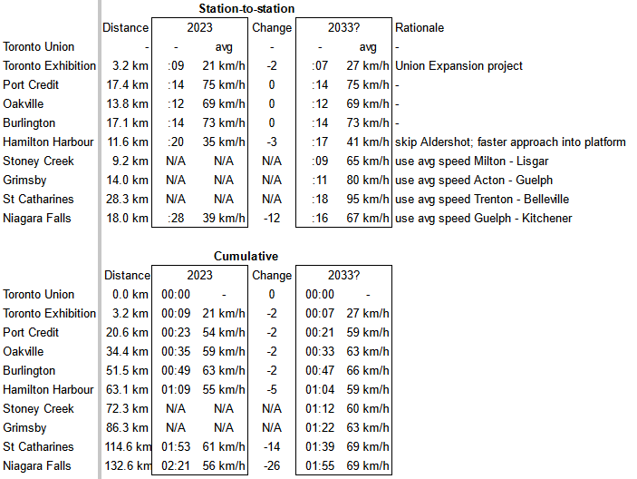

Am I correct to calculate that at roughly 2hrs 41M over approx. 120km of track length, that Toronto-NF service is running at an average speed of 45km/ph? (yes, including station stops)....
Still, that seems ghastly slow.
The distance is 132.6 km so the average speed is 56 km/h for the weekend express train (which skips Hamilton Harbour), but yes we can do considerably better, even with additional stops in Stoney Creek and Grimsby.
If one could get the average speed up to just 70km/ph you would drop the travel time to decently below 2hrs each way. That's hardly seems unattainable.
@reaperexpress likely has all this modelled somewhere........
I wonder what strategic investments would drive the biggest potential speed increases?
Here's a fairly back-of-the-envelope for the following upgrades:
- USRC up to 45 mph (already under construction for Lakeshore platforms)
- Hamilton West Harbour - Stoney Creek Confederation: increase from 30 mph to 65 mph
- Stoney Creek - St Catharines: increase from 65 mph to 95 mph
- St Catharines - Niagara: increase from 65 mph to 75 mph; resolve slow zones in Niagara Falls.
So it looks like we could save about a half hour just by upgrading the CN Grimsby subdivision to the same standard as the existing GO-owned portion of the line. Additional savings are probably possible by further upgrading tracks between Hamilton and Toronto.
I'd also need to do a quick check on the scheduling. It's already possible to run hourly service with the existing track configuration but it might require a longer dwell in Hamilton to make the trains meet in the right spots.
Awesome contribution, as always; thank you!

Good points.
Based on your point about bridge speeds, it may indeed be futile to raise the limit above 65 mph east of St Catharines. Nearly all the time savings came from resolving the slow zone in Niagara Falls anyway so it doesn't make much difference if the limit is still 65.
I figured that the hourly service pattern would involve meeting on the bridge so it only needs to close once per hour rather than twice. In which case the terminal time in Niagara Falls needs to be about 25 minutes anyway which would act as the buffer for NF-bound trains in case of bridge delays. For Toronto-bound trains trains I'd definitely add some extra padding at the bridge to reduce the chance of cascading delays down the line.
