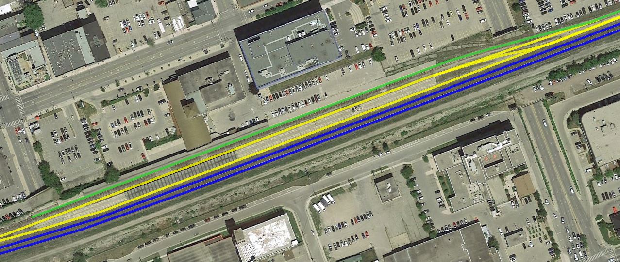

Reaperexpress conceptual track users. Tracks colour coded by primary user, not necessarily track owner.

This conceptual diagram is close to one I've handed to both the feds and province. Two door heights at London are pretty much inevitable unless there's a way to make a parallel VIA service between Kitchener and Toronto make economic sense, and fit on the infrastructure, that I haven't been told about.
However, I had it the other way around, with the platform on track AL01 raised for VIA Rail level boarding, and AL02/AL03 staying as they are for GO operations. There's also room under the Adelaide Street bridge for a fourth track to London East, so trains coming off the Guelph Sub would no longer conflict with CN movements on the Dundas Sub at all. Send out a flash welding truck and a tie crew and the Guelph Sub could be largely back up to Class 4 standards in a few weeks, all for about $50M.
If you really want to fix track congestion on the Dundas Sub to add a reasonable train frequency, and synchronize with regional buses, making London a meeting point, and there's a lot of space where CN took out sidings AL10 and AL11 south of the main. A new platform track and high platform on that side wouldn't be too hard to install, and then we would get something close to a station and service level suitable for a city of half a million. Based on the cost of the Belleville station works, adjusted for inflation, about $30-40M, some of which could be TOD-funded.
Also, lose all the manual, unheated switches... those are just asking for trouble and I've been caught up in it a few times.

I would agree with putting the high platform on the north side. Most VIA trains pass through one at a time, so continuing to use that platform for the majority of trains makes sense, and creates the shortest and levellest path from front door to train. While London needs more than one platform, the design should minimize the number of people who have to be routed through an underpass and up to the tracks.
I don't agree however with not having power switches at the west end of the second and third tracks. There will be plenty of occasions (as there are now) when two trains meet or connect. Having two through routes is essential imho.
Switch heaters aren't that expensive - make the whole thing CTC and maximise its flexibility andd operability.

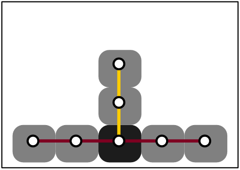

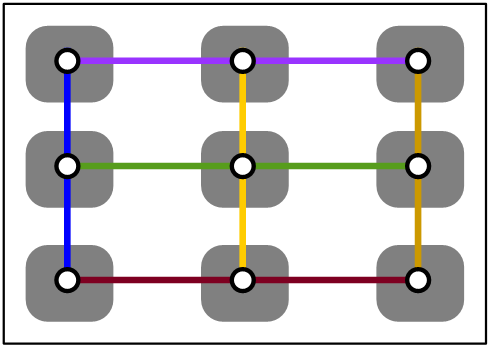

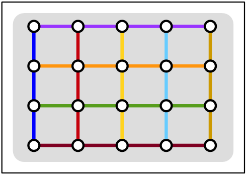

If we are going to look at integrated transit, I think we should look at more then just integrated fare structures and transit services within the GTA. The GTA is effectively expanding, and the GO system should be expanding in different ways to capture that ridership. VIA is not really a commuter service, and it should probably not be one.
There is a finite limit to the amount of highway building and expansion that is going to take place. But there is a great deal of growth that can take place in rapid rail based transit.
