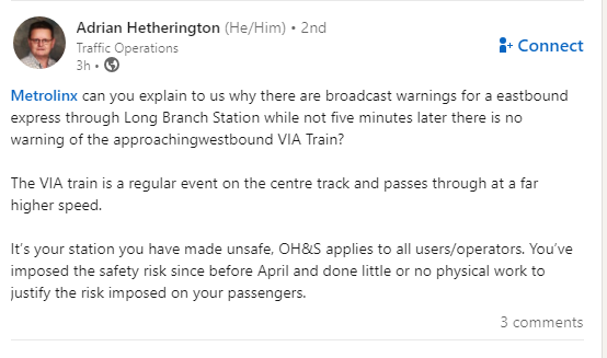

Is it a system/comms integration issue? @smallspy @crs1026
Different systems and different operations, and not enough data being shared between them.
The station announcements are plugged into GO's train scheduling system, not their dispatching system. They know when their trains are on time or late, and can broadcast warnings and changes of that. They can even broadcast platform changes.
But the scheduling system does not display VIA trains on it (it's not a graphical interface), and so they don't know when and where the VIA trains are. Thus, they can't broadcast warnings for when their trains are about to pass.
Hmmmmm… to me this Adrian dude has a (possibly excessively expressed) point. If there are some hazard announcements then people should be able to rely on warnings before all similar hazards. GO should get itself a better system integrated with signalling and not just dispatch, or just have humans with a pair of binoculars and a PA system do it like what could be done before we decided computers were cheaper than headcount.
I'm not so sure it is a OH&S Act matter either.
Sensor detecting trains could trigger the announcement.
