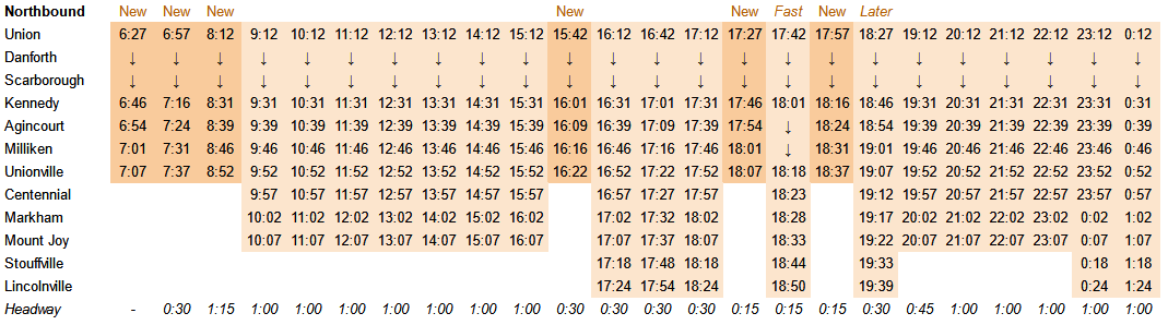

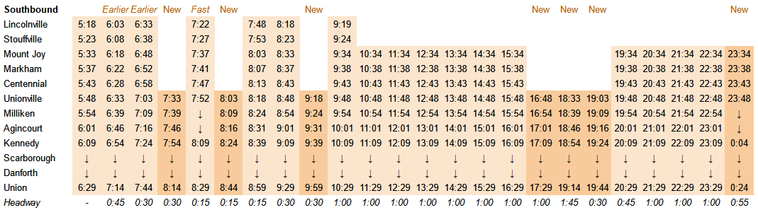

With the new second track between Kennedy and Agincourt finally being completed soon, I thought I'd take a look at what additional service it would enable. The passing track enables 30-minute bidirectional service, but during peak periods we probably want service more frequent than that.
This concept uses the new passing track and existing second/third platform at Unionville to increase the peak period service to 4 trains per hour, and introduce counter-peak service:
Notes on the service design:
  • To make room for the counter-peak service, there needed to be a period of 30-minute service in the peak direction just outside of the peak hour. But since one of the trains turns back at Unionville, that creates a 45-minute gap north of Unionville, which puts a lot of ridership demand on a single trip. So I made that train run express between Union and Unionville to prevent Milliken or Agincourt passengers from using that train. They can instead use the new local trips that will have plenty of spare capacity and still provide the same 30-min or better service as the current timetable. The improved travel times for riders north of Unionville also partially compensates for the less ideal departure times for those riders.
  • I added a southbound trip at the end of service. That trip presumably already exists as a deadhead given that the 23:07 northbound arrival at Mt Joy needs to return downtown somehow. This new in-service trip runs express to minimize the operating cost increase compared to the current not-in-service run.
  • Due to the constraints of running 15-minute peak service on a line with a minimum bidirectional headway of 30 minutes, I wasn't quite able to fit hourly-or-better counter-peak service, but I was at least able to get the counter-peak service gap down to under 2 hours, compared to 4 hours currently.
  • All-day 30-min service to Unionville would be technically possible but would require a lot more crews, and it would still have some awkward gaps due to the need to fit in the 15-minute peak direction service.
