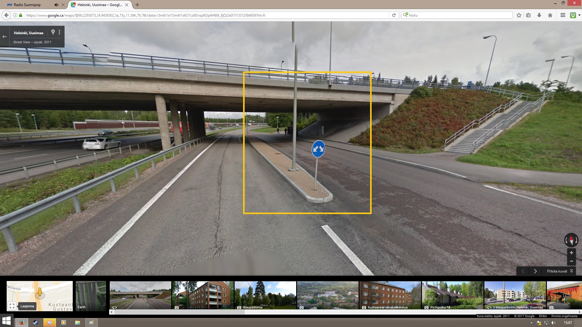

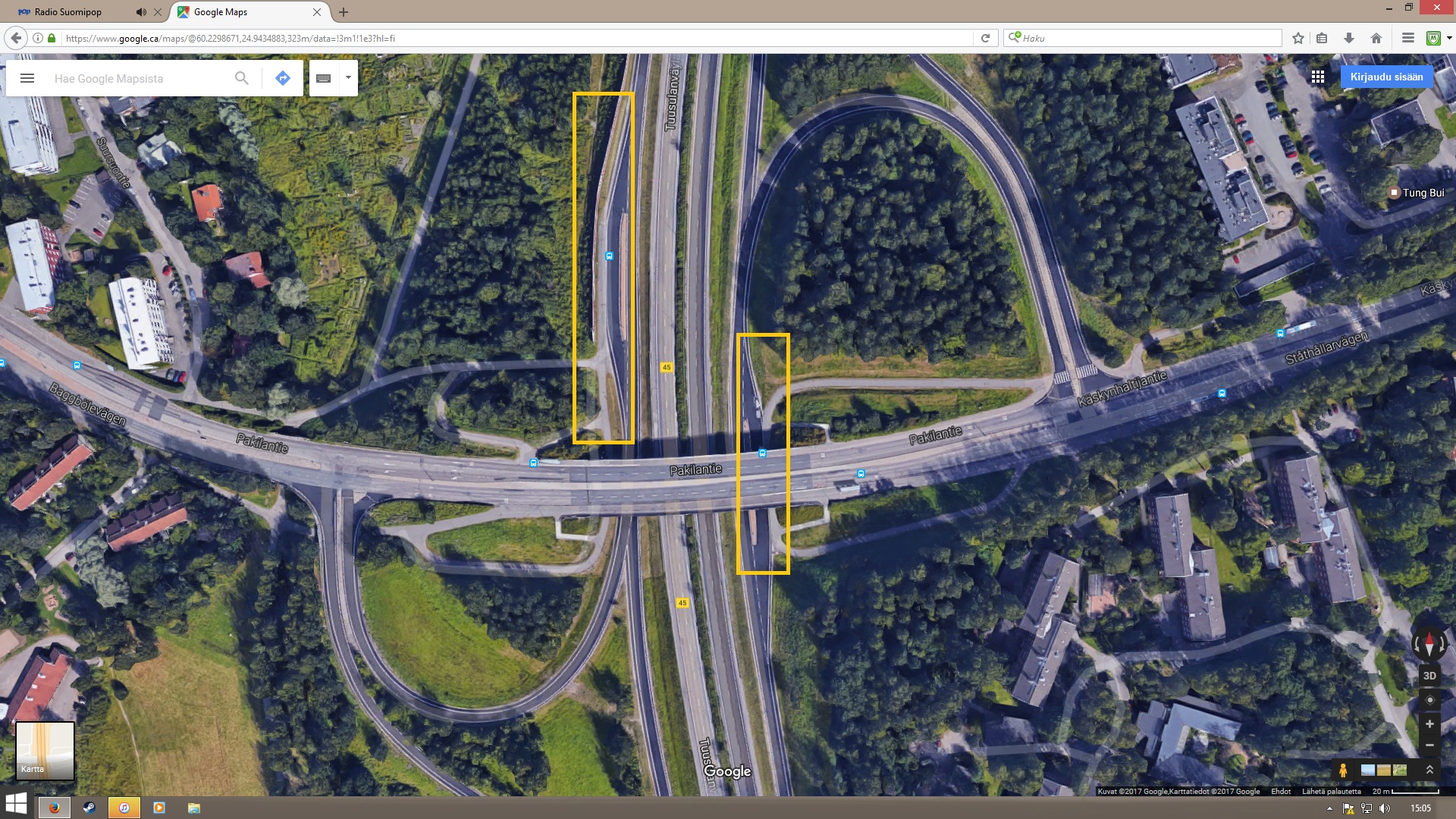

Something I've been wondering for a very long time is whether having bus stops under overpasses along 400-series highways would be feasible (obviously physically separated from the high-speed highway traffic, eg. in between the off- and on-ramps).
This is an example of a typical bus stop along a motorway in Helsinki. These types of interchanges are very common throughout Finland. The amber boxes on the map highlight the location of the bus bays. They are all wheelchair accessible as well.
Here is a close-up of the outbound bus bay at the same interchange, also highlighted in amber. You can see it's clearly separated from the fast-moving highway traffic, by a bus lane along the off-ramp.
Although they are common in suburban Helsinki, they are used throughout the country, primarily for intercity bus services (eg. Greyhound in Canada), so buses don't have to exit the highway to pick up passengers. Typically these stops are accompanied by carpool lots, and kiss-and-ride areas.
The main advantage of these bus stops is that you can build them at every interchange, and the bus simply passes through them, whether there are any passengers waiting or not, without having the bus exit the highway. This increases the catchment area of an intercity bus service drastically.

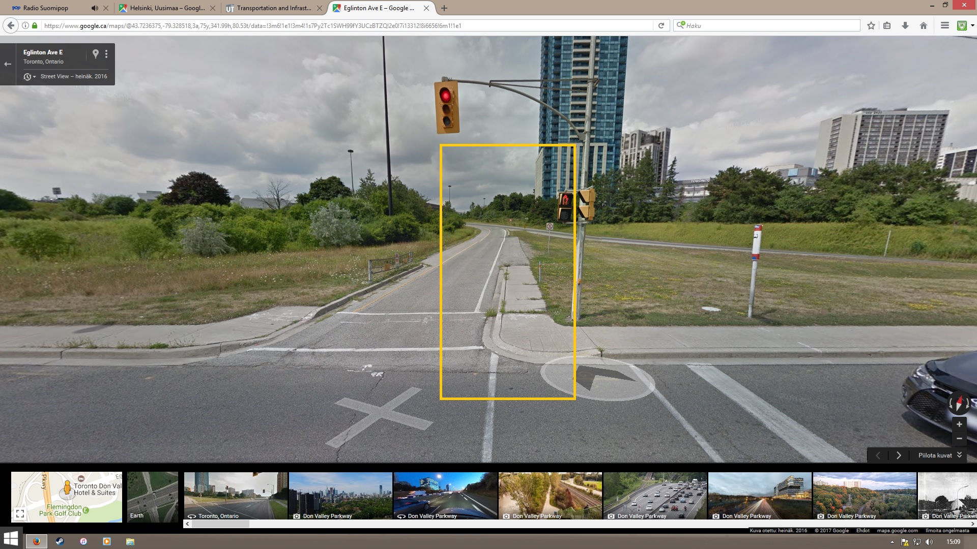

We have an unused example of (fairly similar to) this in Toronto. The NB on-ramp to the DVP at Eglinton features an area that was clearly designed to be a bus stop, but remains unused by long-distance buses, GO buses, or the TTC's route 144.

EDIT: The speed limit on Finnish motorways is 120km/h. If this works safely there, there's no reason it couldn't be done here.

It has been used by both the 144 and what is now the route 61 GO bus at various times in the past. And because it was never well used by passengers, it's been removed from service.
There are other places that have been done in Toronto that do work - Keele at the 401 comes to mind - and others that likely could work should the service be there. But for whatever reason Eglinton doesn't seem to be a good one.

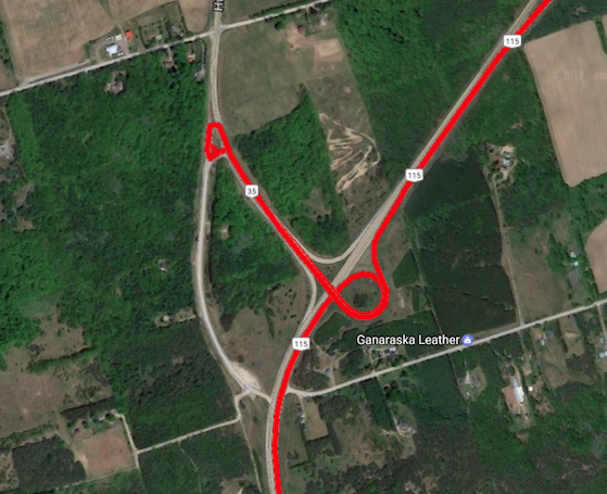

GO Transit are you reading this? For example I took the bus to Peterborough recently, and everytime the bus left the highway to serve a commuter lot it added several minutes to the trip.
