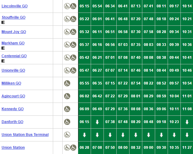

The short answer - to have a reverse direction train during peak, two things are required: there has to be a peak-direction train that turns back at Unionville, and there has to be a 40 minute hole in the peak-direction headway because the reverse direction train has no where to pass other trains between Milliken and Scarboro Jct. There can't be a "next" northbound train at Scarborough until the previous train has cleared at Unionville, and the southbound has come to Scarborough.
The earliest that a train could proceed southwards in the evening is about 1910 out of Unionville, once the 18:35 train arrives (at 19:13). But - there would have to be a train that can be turned back that had run earlier. That would have to be an additional train, otherwise one of the previous trains (before the 18:35 train) would not offer service beyond Unionville. That may be a bridge too far.

During the week, all trains will overnight in Lincolnville. This schedule is being accomodated by storing two L6s on Track 1 (first track parallel to the mainline) and two more L6s on the main at a temporary platform built for this.
On Friday nights, the two L6s that would have laid over will deadhead back to Willowbrook. They will deadhead back to Lincolnville on Sunday night to prepare for Monday.

Fortunately, it was not as feared. No reduction in morning peak service. A definite confusion occured (added trains by extension to Lincolnville) but to allay fears, here's the real schedule on GOTransit providing six options that arrives at Union by 9am:
