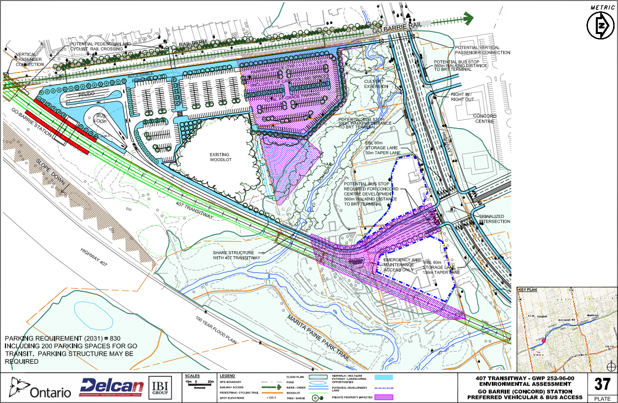

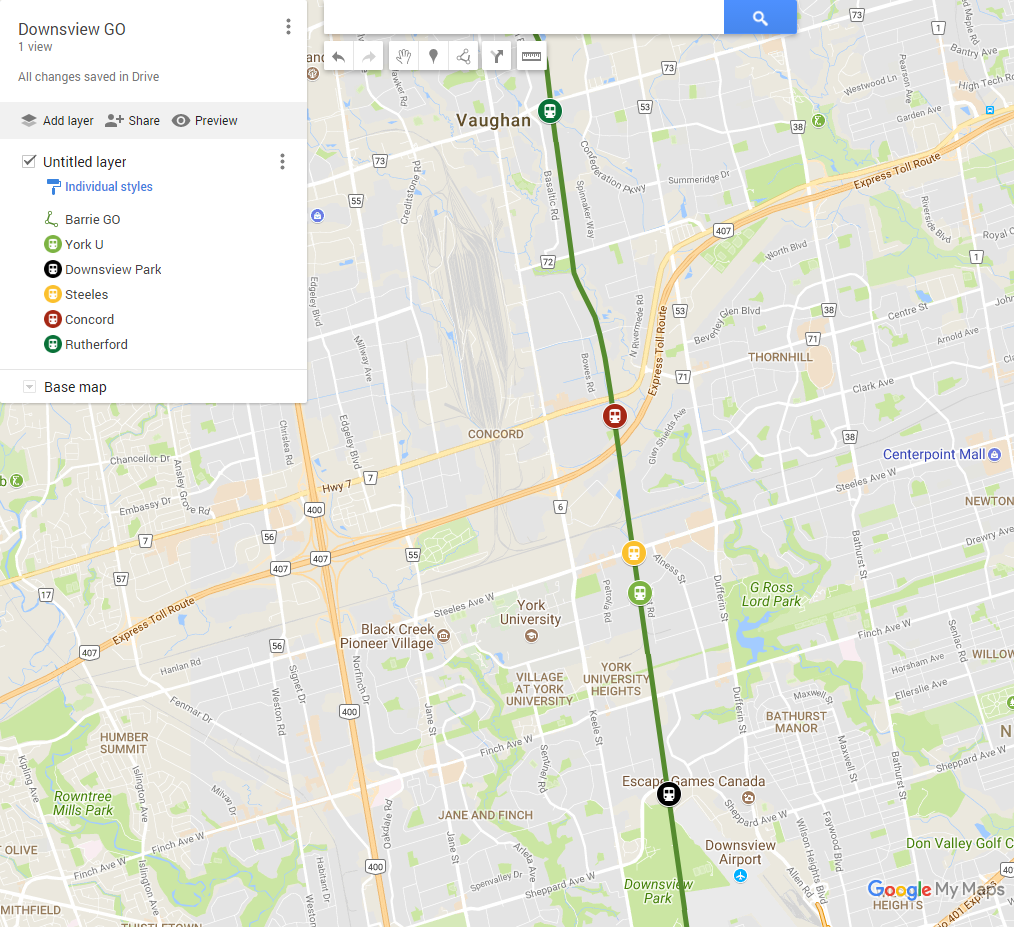

*sigh* I still can't support this theoretical shifting to Steeles when Concord is a better option in terms of spacing and rapid transit network building.
  • Steeles station (shifted York U)
    • To Downsview Park: 3.3 km
    • To Rutherford: 6.3 km
    • Connects to uncommitted Steeles BRT (TTC)
  • Concord station
    • To Downsview Park: 5.3 km
    • To Rutherford: 4.3 km
    • Connects to designed, EA-completed, uncommitted 407 Transitway and committed + partially built Highway 7 Rapidway (GO + viva)

The problem with Concord GO is that there are two competing plans. Local residents didn't like the official plan, so they hired an architectural firm to create an alternate plan. Metrolinx says that plan is unfeasible, but it's not like the residents came up with it themselves on the back of a napkin...
