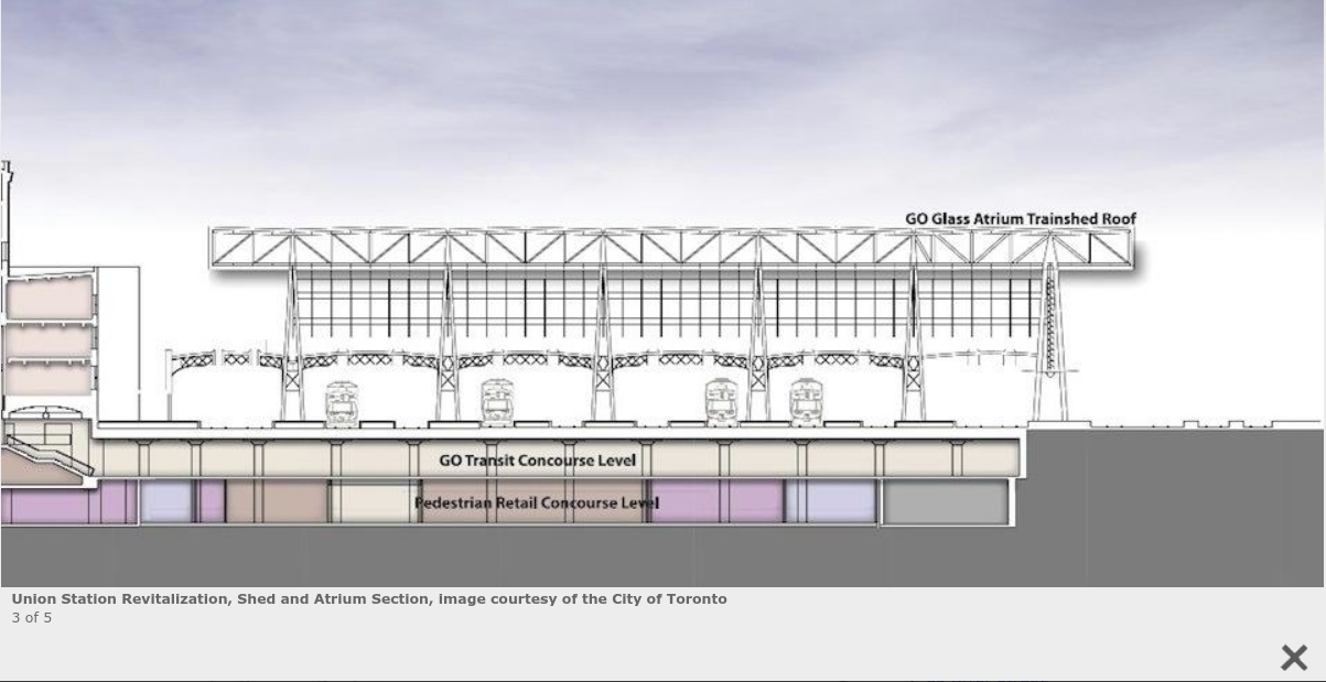

This drawing corresponds to what I remember the engineering drawings being as per track support columns:

I have access to some of the engineering drawings of the property. While that diagram gives a decent representation of what the arrangement is underneath the trainshed, the reality is that it is a very, very busy space in terms of structure.
If you are walking around underneath in the concourses the quick summary is - round columns hold up the track, square columns hold up the trainshed. And you'll notice that the round ones are far denser and more common.
It is just a representative drawing, agreed. But I have seen an engineering discussion somewhere that detailed the pillars as being directly under each track, and what was involved in 'underpinning' them...the inference being that they didn't go down to bedrock. If that latter point was in fact the case (and this is all built on fill south of Esplanade) I'd have to question the engineering, or the written history of what actually was/is the case, as the continental steam locos especially would have pounded those pillars into soft ground.
