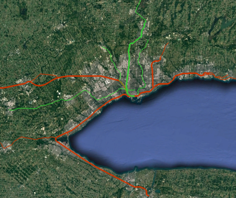

Given that one of the biggest challenges to any platform height conversion is fleet planning, I maintain that the most practical option for level-boarding is to divide the network into different fleet types. The lines shared with VIA/Amtrak or UPX would adopt the 48" standard that those agencies already use, while the GO-only corridors maintain GO's current 25" floor height standard. That way the 25" fleet can be gradually reduced through attrition, similar to how the TTC converted to ATC-ready TR trains on Line 1 by retiring older H-series trains across the network and concentrating the remaining T-series trains onto Line 2.
Lines in red would be 48" floor-height, while lines in green would be 25" floor height. Note that even in GO's current plan, VIA/Amtrak/UPX services to Kitchener, Niagara Falls, Oshawa, Brantford and Pearson would require 48" platforms.
Comparison with all-25" option
GO's current plan is to convert the entire network to 25" level-boarding platforms. The problem is that UPX, Amtrak and VIA will be keeping their standard at 48", which means that shared stations will require two sets of platforms, one for GO and one for everyone else. This results in unnecessarily cumbersome stations with either limited capacity or extremely long walking distances. Freight access is actually the same in either option - even in the current plan, GO is building gauntlet tracks to let freight trains by their 25" level-boarding platforms.
Comparison with all-48" option
The challenge with the all-48" option is of course the 700+ Bombardier Bilevel coaches that GO already owns. Since some of the lines don't share with other passenger services, there is not as big of an advantage for 48" platforms. It's also worth noting that the lines I suggested to maintain the 25" floor height include those with higher freight and lower passenger train volumes.
As far as GO RER is concerned, "level boarding" is likely to be even with the lower level of current GO bilevel cars. As much as I'd prefer them to target the middle level (with stairs up and down creating 2 internal flows toward the train doors) I doubt that'll happen.

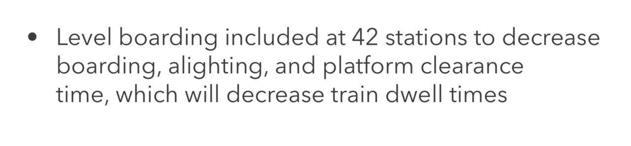

The real question: what do they mean by "Level Boarding"? Are we going with the 48" Platform heights or heights similar to those found on the existing GO Network?
And with regards to escalators at union, why didn't they do this when they were doing the renovation? This is going to cost significantly more and make the place even more of a nightmare. Let's just hope all the food options in Bay are good when it opens.
