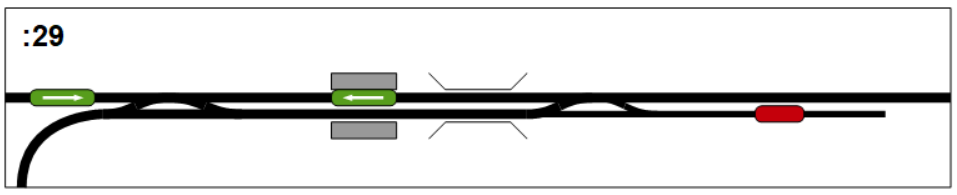

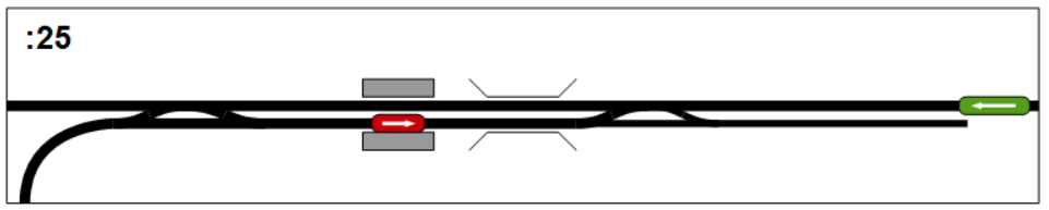

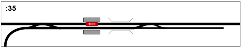

If the meet between eastbound and westbound Kitchener trains happens at Guelph as I suspect, then here's how the meet would work. Let's say that the meet happens at :30 past the hour.
0:24 DMU arrives on eastbound platform, dropping people on the same platform where they catch the train to Toronto
0:26 DMU departs eastward across the bridge and sits in the tail track
0:29 Westbound GO Train arrives at westbound platform
0:30 Eastbound arrives arrives at eastbound platform
0:31 Westbound GO Train departs
0:32 Eastbound GO Train departs
0:34 DMU moves to westbound platform, picking up GO passengers in the same spot where they were dropped off
0:36 DMU departs to Cambridge.
At this point both of the single-track lines on either side of the station are occupied by the trains that just departed so no other train can arrive in Guelph for at least 30 minutes. Even if one or both of the GO trains is delayed, the DMU can sit around and wait for them without being in another train's way. The other slot available for CN / VIA / GO trains is offset by 30 minutes from when the DMU would be around, so during that half of the hour the DMU wouldn't be anywhere near Guelph.

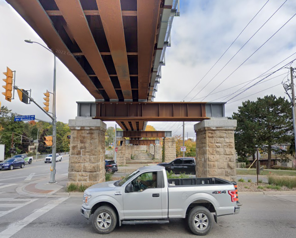

The bridge east of the station was always designed for two tracks, and Metrolinx recently replaced the cross-beams so adding a second track across the bridge should be pretty straightforward. The same cannot be said for trying cram a third platform into the station somehow, which would involve widening an embankment, building a new bridge over Wyndham Street and probably rebuilding the elevators and stairs on the south side of the station.
I figure Metrolinx would want to double track the bridge at some point anyway so the cost is not only attributable to the Cambridge DMU.

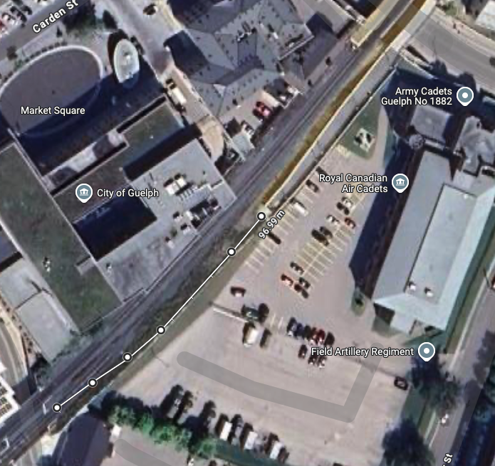

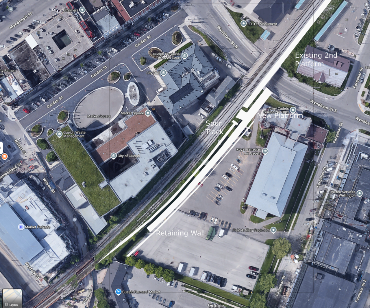

Would it not be possible to have a small siding, capable of holding one 2 or 3 car DMU? A retaining wall would be needed and a connection to the new (currently unused) southside platform. The Wynham bridge (nor any other bridge) would not need to be widened. Also a storage siding could be easily accomodated between Alma and Edinburgh, furher West in case a train needed to be stored for whatever reason.... The only downside is if the service wanted to ever use larger trains, this scenario would not work...
It looks like that might be feasible but it looks like it would be less convenient and more expensive than building a tailtrack east of the station.
The construction cost for this design would be much greater than just ordering some additional spans to place on the existing abutments east of the station. This design requires significant regrading and retaining walls - even more signifcant than shown in your image because the existing eastbound platform actually extends much further west than you've shown.
The main issue with the design is the transfer distance between the westbound train and the DMU. If you get off the east end of a westbound train, you need to walk up to 400 metres, including an elevator and a long ramp. And the distance from the east end of the bus terminal is even more.
Such a long transfer distance means that there needs to be a long transfer time from westbound GO trains to the DMU that is always provided even if the GO train is late, to accommodate people with limited mobility. Longer transfer times make the connecting service less time-competitive, and the long transfer distance is physically exhausting, especially for more elderly passengers, which also makes the service far less attractive than a same-platform transfer.
So while it may be technically possible, it would provide a significantly worse passenger experience and would be more expensive than building a trailtrack east of the station.
The construction cost would be much greater than the tailtrack option due to the significant regrading and retaining wall required. The existing eastbound platform actually extends much further west than you've shown, which precludes the illustrated design due to the short distance to the Wilson St bridge.

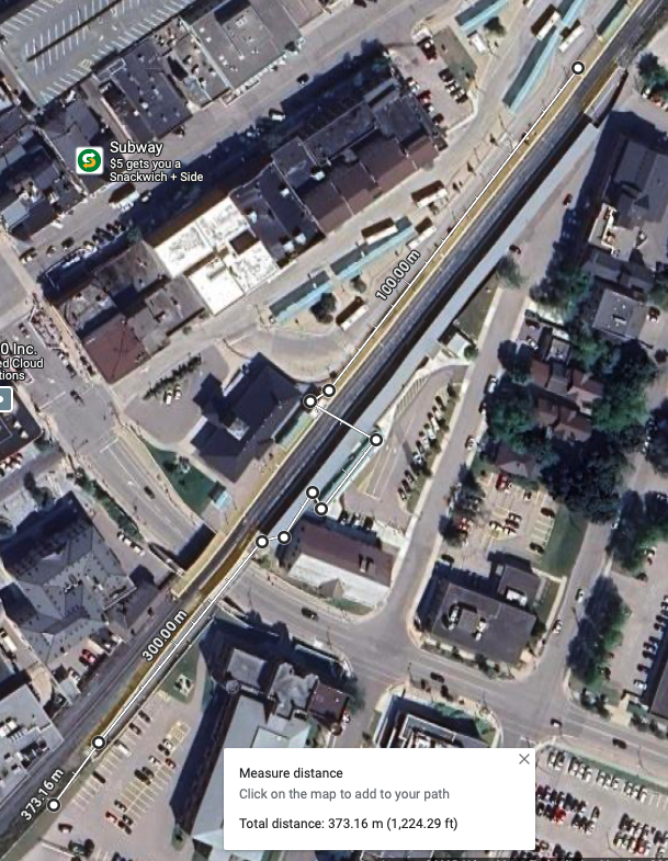

Wouldn't a station east of the bridge be a lot further? I would think my option at least you could connect from the same station - I would imagine a seperate station being a much worse passenger experience? Also, seasoned regular users would position themselves closer to the transfer point. Also, the east end solution REQUIRES double tracking the Speed River Bridge. I figured a retaining wall and some grading much less costly. Maybe the spur track come around next to the existing platform? Where did you get your image? (much more up to date than google!)
Nobody is proposing a station east of the bridge. It's just a tail track. See the diagrams in my post above, the platforms are just the two existing ones.
You need to design the transfer time around the slowest user, not the fastest user. And no matter how well you position yourself on the bay platform, you're never going to match the convenience of the tail track option that drops you off on the same platform where the next train picks you up.
Adding retaining walls and acquiring property would definitely be more expensive than adding a second set of spans to a bridge that already has the abutments for them.
