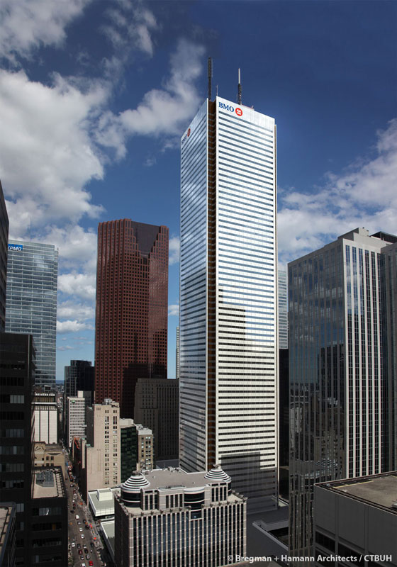

How tall is First Canadian Place? Most sources say it's 298 metres tall to the roof of the Mech. But, Google Earth says its closer to 292 metres in height.
What is the source for the 298 metre height? I cannot locate a reliable source for that number. It seems to have been lost over the decades...
Could the recladding of the tower in the early 2010s have led to additional height on the exterior?
Not significantly. The inside corner parapets are slightly lower than the straight wall, by approx a foot. I believe everything was at one elevation prior.

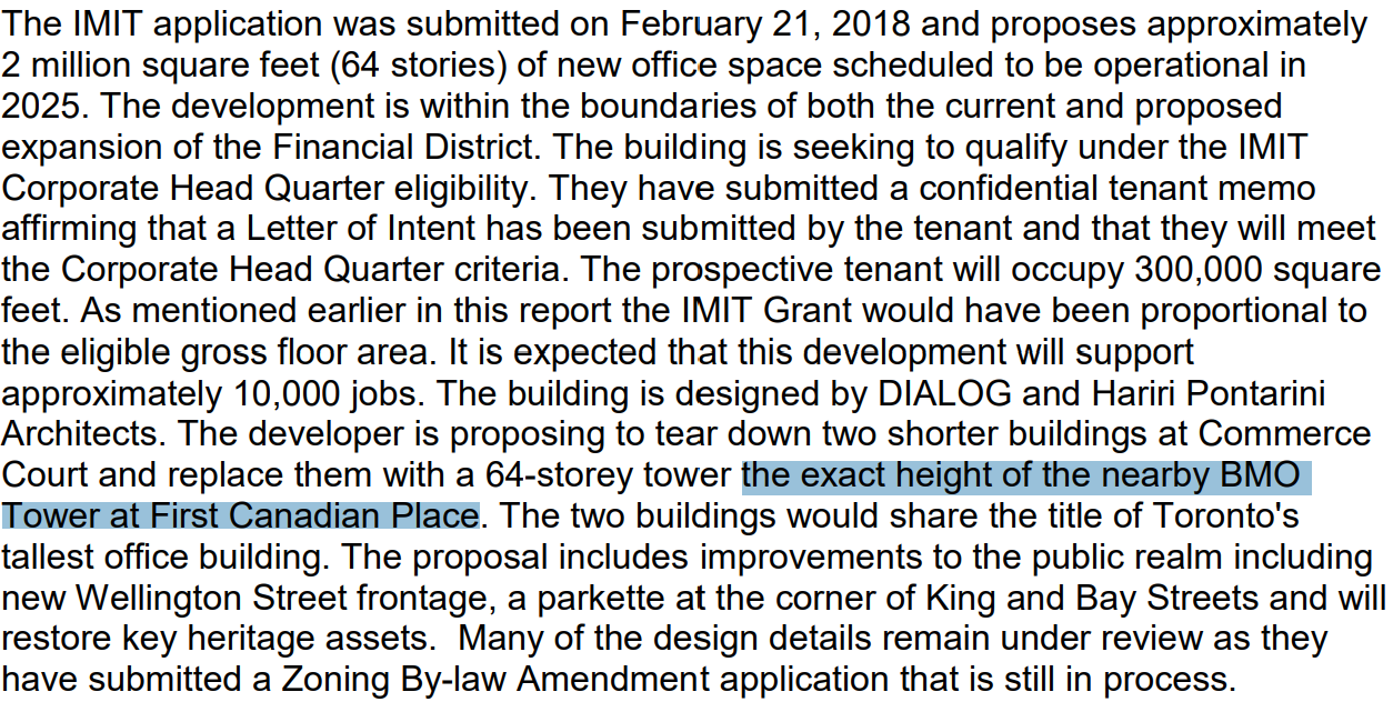

Without seeing the elevations I can't add much insight further than what @innsertnamehere has provided. The zoning bylaw has a maximum of 287m for the 100 King W parcel, but keep in mind FCP was built on an as-of-right basis because zoning bylaws regulated only density in parts of the downtown core prior to City Council passing the Central Area By-law in 1976. And maximum height allowances also would not include the mechanical box and further fixed architectural protrusions above shown in @wopchop 's post. There is mention of FCP being 287m in various city staff reports for surrounding proposals in the last couple decades including for 311 Bay (St. Regis) and 40 Scott, however they are likely referring to the ZBL maximums and not accounting for architectural protrusions.
There is a passage in this report that states the 2018 submission of Commerce Court 3 would have been the exact height of FCP, which would mean it is 289.65m.
But again, non-standard height definitions and can't confirm anything without the drawings.
So, all that does is move the goalposts back... the question now is where did DIALOG get that number from? And... why is it a full 6 metres off what Google measures?
