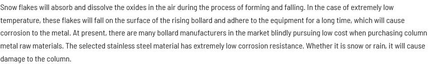

Some of the challenges are very real, and some are not necessarily fixable in the same way as City 'x' without a series of other changes. For instance, rising/retracting bollards and road salt are not a good mix.
From a manufacturer of this type of system:
There are also issues with the hydraulics function in extreme cold.
Also utility conflicts can be a major hassle.
None of which is to say that we can't use this tech here, but its not as easy as choose this tech, order, install. There's a lot of moving parts.

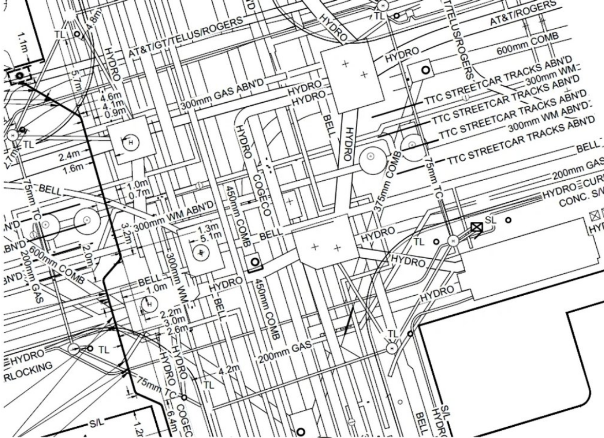

On the subject of utilities. I think it might be useful for some of you to see what an actual intersection in downtown Toronto looks like, below the surface, so you can understand the challenges faced by City units trying to improve them.
