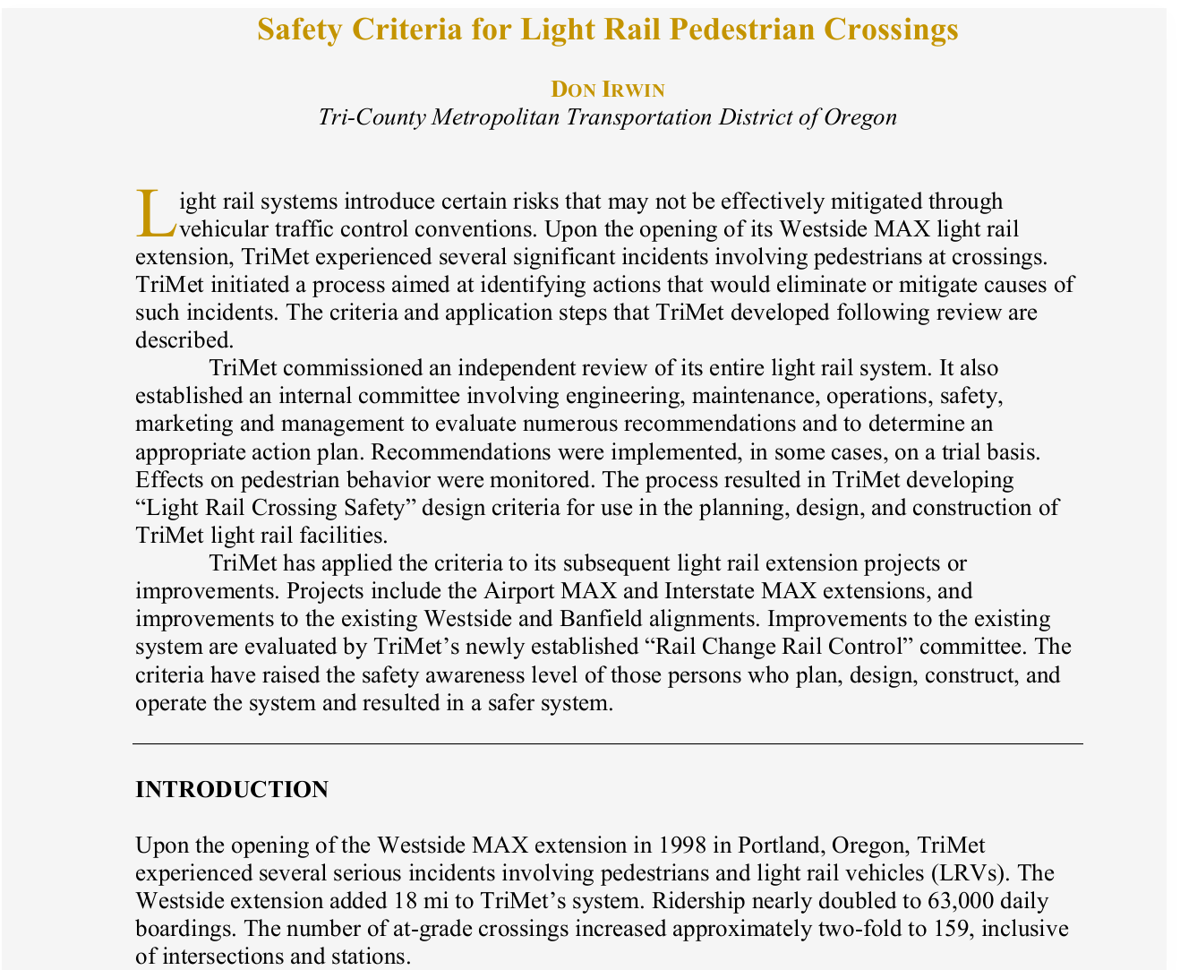

Exactly. I've just found time to start reading some of the reports from other jurisdictions, and as mentioned previously, almost all North Am LRT operators physically separate pedestrians from the tracks, some (and San Diego Trolley does this too) not only fence off the tracks, even for street running sections, but gate access to those tracks:
[...continues at length 23 pages...]
http://onlinepubs.trb.org/onlinepubs/circulars/ec058/08_02_Irwin.pdf
It itemizes with engineering drawings and national transportation org reference for all the devices necessary to ensure safety of adjacent pedestrian areas, including gated access. But of course, Torontonians are far smarter than anyone else, and don't need such measures...
Full report attached

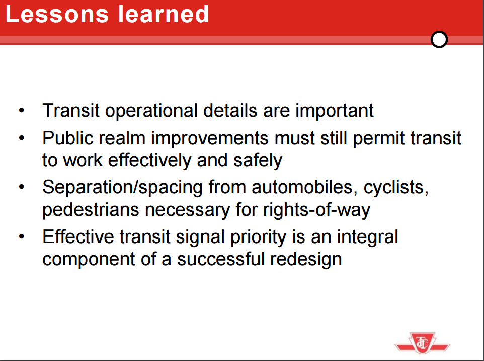

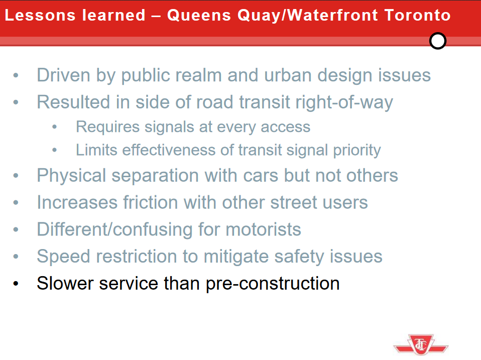

Further to 44's posted pic:
https://www.ttc.ca/About_the_TTC/Commission_reports_and_information/Commission_meetings/2016/July_11/Reports/9_The_Importance_of_Streetcars_in_the_TTC's_Integrated_Trans.pdf
