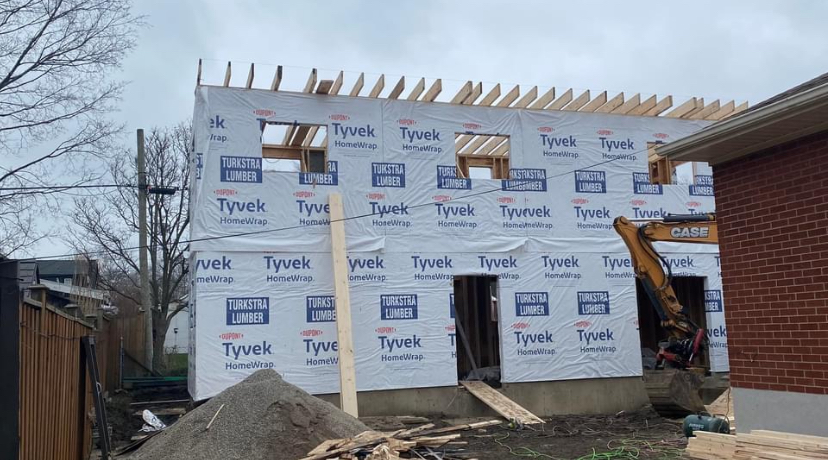

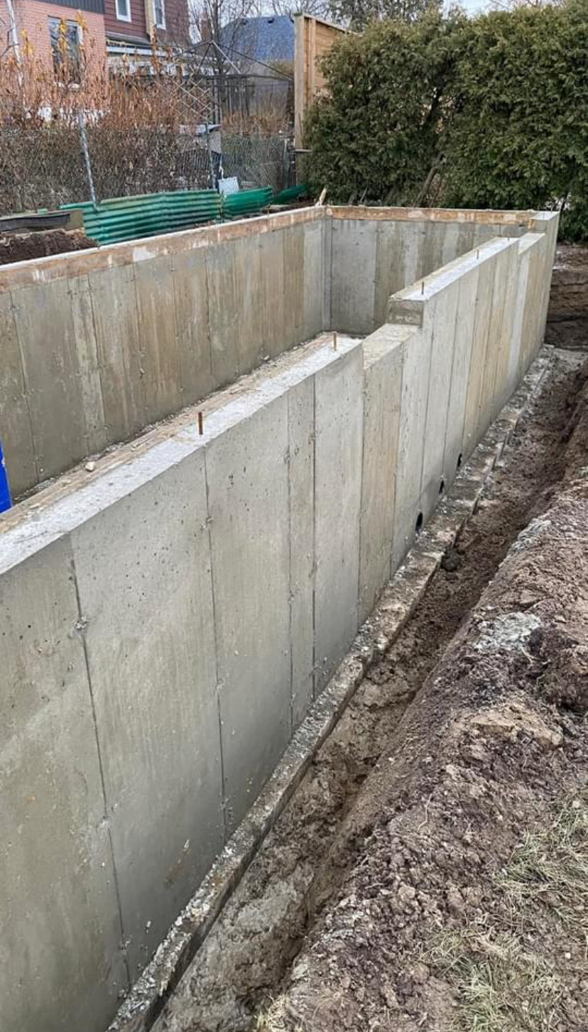

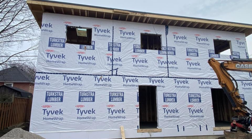

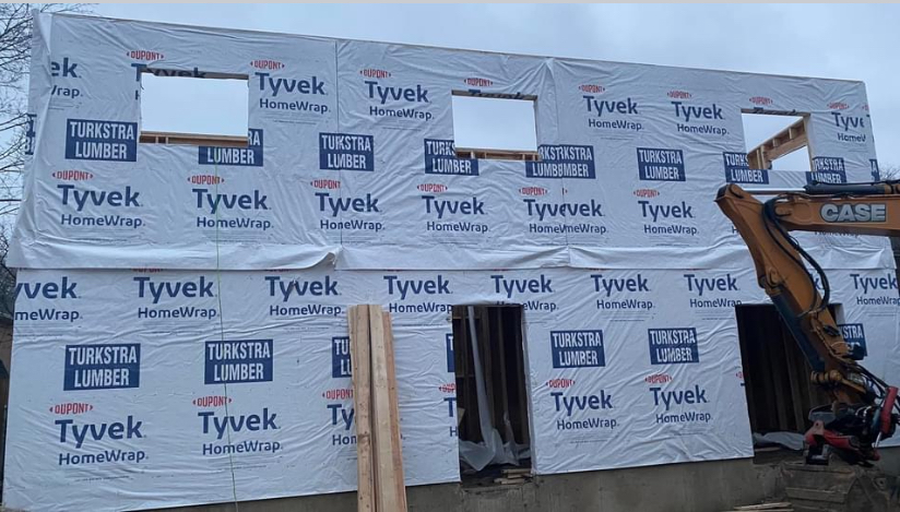

Guess I should post my own project. I'm building a laneway house in my backyard here in Hamilton. I demolished an existing garage (not in good enough shape for conversion) and I'm building a 1.5 storey house. Same footprint, a bit taller. I have a private laneway off to an adjacent street on one side. I started the process in December 2022. Permits issued in October and excavation began in December of last year. Ask me any questions!

Good questions! This was all new to me, but I am not on a deadline so that helps...I can learn as I go.
- I needed a variance for the setbacks. I went to Committee of Adjustment and although staff recommended approval to some and denial to other variances, the committee overwhelmingly approved everything in a few minutes. I'm in downtown, so that seemed to help.
- I started with an architect in January. Variance granted June 1. Needed to get a full survey and grading plan to accompany the permit application package, but permits finally issued in October. It wasn't bad; a bit of back and forth but not unreasonable.
- I'm acting as GC and subbing everything out. Quotes have been pretty varied. It's coming in where I expected so far. I am still debating whether to hang the drywall myself. I've done a lot in the past but there is some tricky ceiling access here.
- Nothing unexpected yet, thankfully! I need to figure out access to the loft still, as it's "storage" space and I don't have room for a full staircase. The approved plans have an access hatch (attic style) but obviously I want a better way.
- It should be enclosed tight by end of this week, pending decent weather. Then we start interior stuff (HVAC>plumbing>electrical>insulation>drywall). So ideally get occupancy this summer?

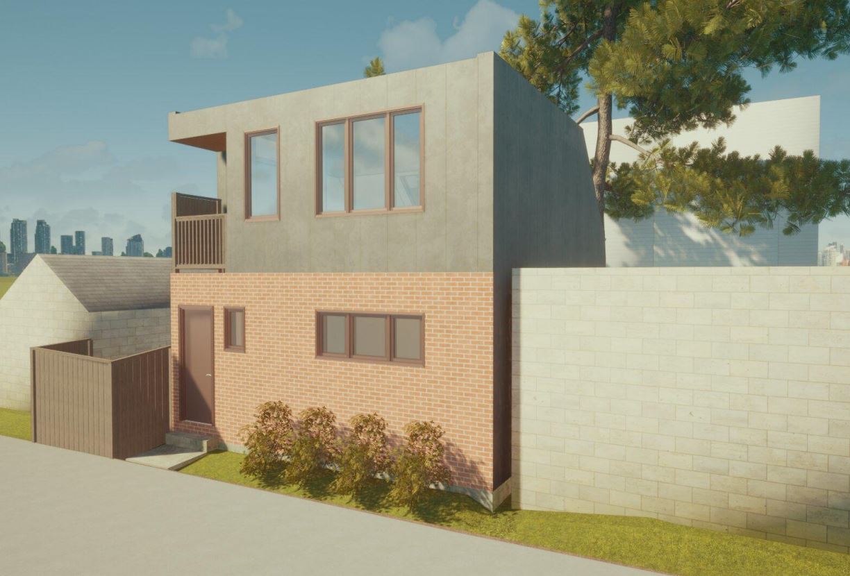

567 EUCLID AVE
To construct a new two-storey ancillary building (laneway suite with a second storey balcony on the southeast corner), in the rear yard of the property, abutting the laneway (Jewish Folk Choir Lane). The existing two-and-one-half-storey semi-detached dwelling will remain unaltered on the site and the existing rear detached garage will be demolished.
