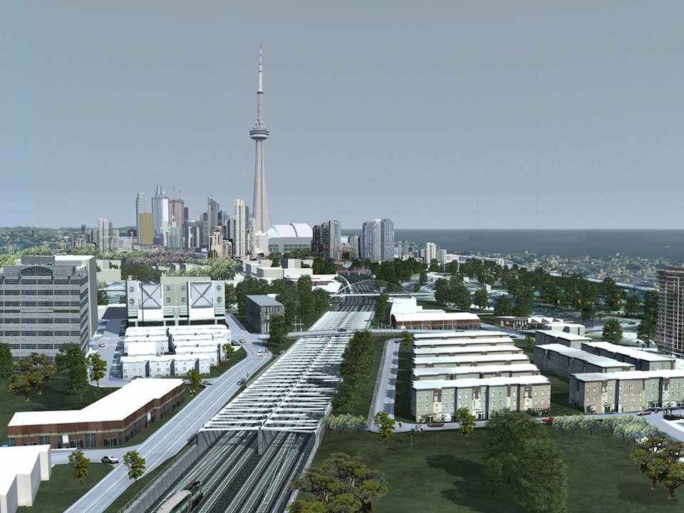

I don't get the question. The decked over parts of the corridor are to the east of where this bridge is located. The only other option here would be a tunnel, which poses its own set of constraints.

The bridge is immediately next to the decked over corridor. Just completing the decking would create a land bridge right next to where the planned bridge would go, except it would be a more natural and seamless crossing and contribute to the goal of RailDeck Park. There are clearly no sight line issues because the Strachan Overpass was designed and built with the rail operators’ input.

A photo says a 1,000s words and its saying a lot. There is no land on the north side for a ramp and without using the green belt on the south side, there no room for a ramp.
This is at the east-south end of the plaza.
This is where the 8 tracks are almost at 80% grade level and you need good sight line coming up that grade and can see the signal bridge to the left.
The only issue I have with the bridge that it only has one elevator and no thought what it means when it goes down for x reason or for maintenance for the people who really need an elevator in the first place.
One has to wonder if the other bridge north of King will get built like it was supposed to be over 5 years ago and can recall which project it was for at this time.
Well yes - technically. About 75 metres to the east.
This bridge is (if going along King) at Douro and King. The decking starts half way between Douro and Shaw.
Wish I had a good plan with elevations. It does look like the decking isn't at grade when it starts. But it looks a lot closer on the south than the north, where it looks very high in Streetview.
I've got to wonder if they planned this a lot earlier along, they could have built in some small hills somewhere or something.
edit - oh just saw other replies. And from that great photo above, the north side would be difficult. But I'm not sure it had to be. Think of that hill just west of Sudbury south of King for example. But too late ...
Actually, the bridge will be further to the west of where you've indicated, in line with the north-south segments of Douro and Western Battery. Look at the EA - they'd looked at alternate locations and found the one they are building to be the best for everyone in the area, save for a tunnel slightly to the west.
And while I don't disagree that it would be nicer from a design standpoint to continue the existing decking over to the point where the bridge would cross, it doesn't negate any of the design features that are going to be built. Look at how high those buttresses are by the time they end - they're already 10-to-12 feet off of the ground on the north side. As the corridor climbs to the west, so would any additional buttresses or elements over the corridor. No matter what, you need to have a bridge that high to clear everything.
Which I guess brings up the next question: are we building the infrastructure for aesthetics, or for practicality? You can build it with both in mind, but if it looks good and is out of the way of most of the users, it's going to be a waste.

This is so over built and overthought. Why not just deck over a small portion of the already structurally decked over rail corridor? A grassy land bridge would get people over and directly into Liberty Village.
Though that raises the question of which portion of the already structurally decked over rail corridor DOESN'T clear the sightlines for the signals and the future overhead?
You'd likely want to take the bikes up and down the elevators, as yes, those stairs look awful for that.
Big ugly clunky graceless thing.
What you state though, is the product of it being positioned so far 'up the ramp'. If it were integral with the present deck truss, any access ramping need would be minimal. Or there could be an elbow turn west from the north end above the roadway until it reaches an optimal point to ramp to grade.
I think it's worth another serious look.
